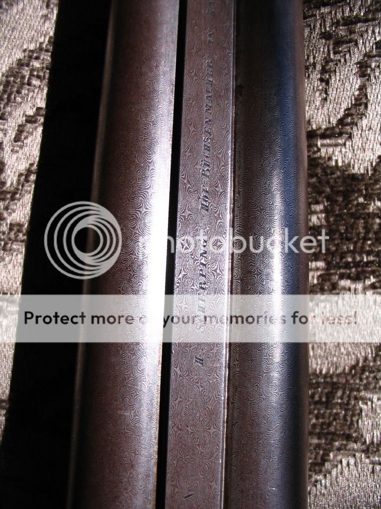

H. Scherping 24 bore - M-4 correct me if I have the images mixed.

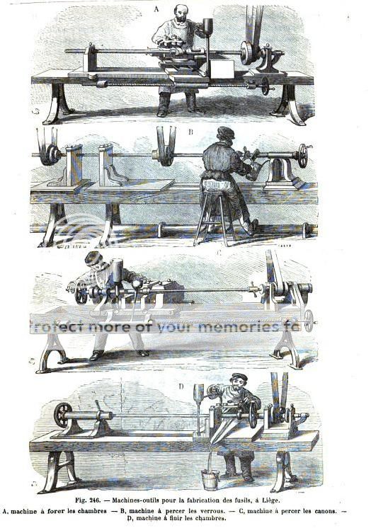

I think that is Ford with his back to us???
I believe this to be from an 1868 text
A. Machine a forer les chambres
B. Machine a percer les verrous
C. Machine a percer les canons
D. Machine a fluir(?) les chambres
