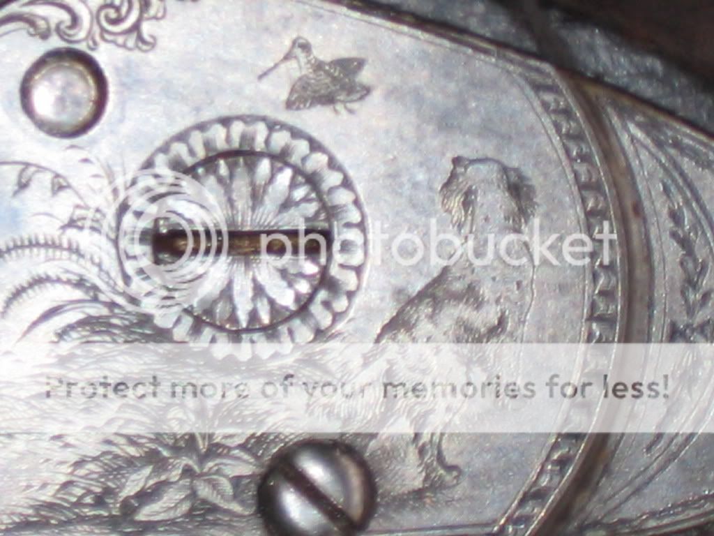

Dave, This dog flushing a woodcock on my sidecocker is about as alive as I've seen. Any idea on the engraver?

Dr. thanks and I will post a picture showing Glahn's engraving with his signature for people to use as a comparison. As far as some type of symbol used instead of a signature, I don't know of any for Spangler. I do know that some engravers used a symbol and maybe all did, but again I do not know.
Richard, that is a very life like setter, but I would be guessing on who did it.
In records kept by L.C. Smith Maker and the Hunter Arms Co. it showed who transfered from Syracuse to Fulton in 1889-1900 when L.C. Smith sold the gun works to John Hunter.
The Spangler brothers and Jacob Glahn and his three sons, George, Theodore and Gus. Jacob Glahn died in 1892 and the sons continued to engrave at Hunter Arms until around 1905.
In "Steel Canvas" R.L.Wilson describes Theodore as a very talented engraver who engraved a Colt gun for Teddy Roosevelt, and Jacobs brother Wilbur went on to become one of the Colt Firears Co's greatest engraver.
So until more signed engraved guns are found for comparison to ones that aren't signed, hopefully we can find a symbol to identify different engravers. I'm sure they all have them, and most of the engravers back then knew each others work without seeing a signature.
DrBobs signed Lefever.
This is signed Glahn sc (sc means scribed)
this one is not signed but these two guns are consecutively numbered and would most likely be the same engraver.

Skeettx, the engraver of the Baker would be Frank Mason.
Originally Posted By: JDW
I am trying to do some research on A.E. Spangler and his brother Wilton, engravers for both Lefever and L.C. Smith shotguns and possibly others. I am not sure which one is the better engraver, but his dogs have no equal.
On the Optimus Grade mentioned above, it is signed Spangler sc on the side lock plate.
If anyone has a picture of this gun and a link to it, as I haven't found one, I would appreciate it.
The only reference and small picture I have is in the book "Steel Canvas" by R.L. Wilson and in enlarging it, the resolution is lost.
Dr. Rober Decker was kind enough to send me some close-up pictures of his high grade Lefevers with Jacob Glahn's engraving and signature, but did not have any with Spangler.
Thanks.
I left this out, but Spangler/s did most of the engraving on the early Baker-Smith guns from 1880-1884

Please allow me to make a small correction. In the 19th century and earlier it was common for engravers to use S.C. after their name rather than the later form of Eng. (or Inc. [incisore] as used by Italian engravers). The S.C. was an abbreviation for sculptor. I realize that it seems like sculpting and engraving are two different things but it was a tradition. This does not just apply to gun engravers. On the contrary, it was mainly used by those who engraved wood blocks or copper plates to reproduce art. Gustave Dore' and his staff of engravers are a good example.
On another note, I have noted a number of threads here where someone was trying to determine an engraver's identity relative to an unsigned gun by looking at the animals and game scenes. When I am evaluating a "who dun it", it is the scrollwork that is usually the key to an engraver's identity.
Most 19th and early 20th century professional gun engravers used pattern books for their animal and game scene examples. Those who were formaly trained in Europe and England were also taught very specific ways to engrave the most common animals. Unless I am looking at animals on the level of Fugger or Churchill, I really can't make a positive ID that way. Scrollwork is almost like an engraver's fingerprints. This is especially true of American engravers who were allowed to work in their own way as contrasted with Austrian and German engravers working in their homeland where they were held to rigid standards. When it comes to what we call German scroll (called "grund Englisch" by Suhl engravers and "Altenglisch arabesken" by Austrians) it is almost impossible for me to discern the engraver's identity because of the uniform way it is executed by Suhl or Ferlach trained engravers. I could go on and on about this topic but I will just leave it by saying that good detail pictures of the scrollwork is what I and other engravers need to see for a good assessmant of the engraver's identity.
Cheers,
Roger

Pete,
I missed your article on this, and thanks for listing it.
Roger,
Thank you for the correction and the tips on what to look for. In a few signed engravings that I have, I will start to look at the "bigger picture" than just looking at the dogs. That makes sense, I never paid attention to the scroll work mainly because it wasn't as interesting as looking at the dogs.
Again thanks for your expertise.
David

Roger, the Glahn signed guns I have seen have SC. behind the name rather than S.C.
