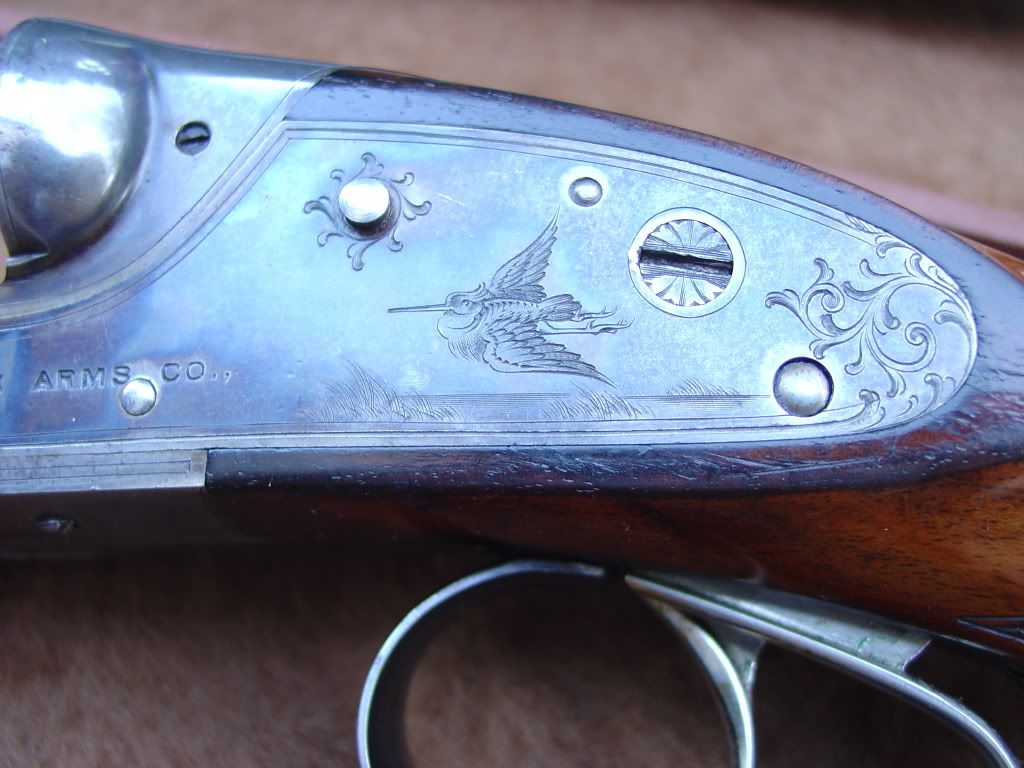

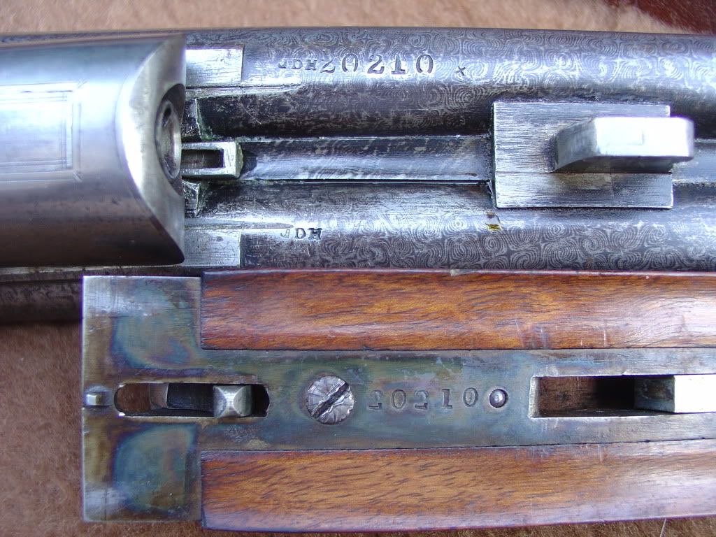

I've not seen this mark before...I'll shut up and let the pictures do the talking. There's many more photos of this F grade if anyone wants to see more. The condition is better than I usually see. It came with another F missing the fore end.

Thank you Robert. 'ADH' of Arthur-Delvaux-Heuse de Fraipont has been found on Lefever, Syracuse Arms, and Baker (both Baker Gun & Forging-Twist and Batavia-Damascus) doubles. Have not seen 'JDH', and it doesn't match the names of the Syndicat des Fabricants de Canons de Fusil de la Vesdre at the bottom here

Are you sure the last letter is an "H"? Looks like more of an "M".

Yes it's an H...you can probably see alot betterif you hold crtl and hit + and zoom the photos. Also the other F has a screw just forward of the operating lever, is that a common trait on Lefevers?

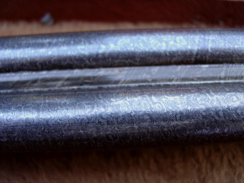

The other F grade (missing FE) is also damascus but it stamped
GL with a crown above (like Delcours crown mark). I can post photos if you want it for your records.

I agre with Ken it is not the letter "H" but sure it is the letter "M" and the maker is for sure Jean Delcour.
the letter M was used for "Manufacture"

This mark has not been seen before. I am inclined to consider it an importer's stamp, unless some one can find a catalog that definitely ties it to a maker.
