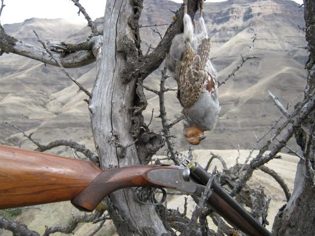

You might really like an Elsie. They usually handle very well, IMO, especially in the smaller gauges. While I use a 20 ga. 687 SP II Sporting for 90% of my dove work I take my 16 ga. Field Grade Smith out for late season doves a couple times a year, and shoot it just as well as I do the 687, even though it is choked very tight in both barrels.
Look until you find a really nice one. They are out there.
16 ga. FWE, 32" Field Grade with Hunter One Trigger
SRH

L.C. Smith's take a bad rap for having cracks behind the locks. Most of this is from shooting the wrong type of shells through them over the years.
In looking for a 20 ga., anything before the mid 1930's will be chambered 2 1/2", and any that might have been made in the factory with 2 3/4" chambers will have Chambered 2 3/4 Inches in an oval on barrel flat.
Guns made later in the 30's will have 2 3/4 inch chambers and will be stamped as such.
16 ga. were chambered 2 9/16" and the bores were .650. The bores in later guns were .662 and in the late 30's the chambers were also lengthened to 2 3/4" and will so be marked on barrel flat.
Stan if the gun in your picture is a 16 ga with 32" barrels you have a rare one. Not many 20's or 16's with 32" barrels out there.
David

David,
I am not an avid L.C.Smith collector, but knew that it was indeed very unusual, if not rare, to find a 16 ga. Field Grade that had the combination that it does, 32", HOT, and ejectors. When I found it on a table of Elsies I actually had my pick of two 16 ga. 32" Smiths, but the other one was a graded gun in high condition, and I wasn't willing to spend what it cost. Here is a pic of it full length. Sorry for the leather lace-up, but it is my favorite way to get an easy 1/2" more LOP on a classic gun.
SRH

Stan, yes they are very uncommom and especially in the options you have. Lools like a decent piece of wood for a Field Grade also.
Under the for-end does your have a piece of metal shaped into a U between the barrel's for-end hanger (loop) and to where the barrels are joined at the water table? They call it a re-inforced splinter.
It is there to take the load off the for-end loop from coming loose when doing a lot of heavy shooting.
David
