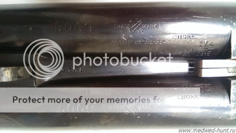

Raimey,
It could not have been more than one or two words that were obliterated. The only letter I could make out is a capital "E", which appears to be the next-to-last letter, given the length of the scratches and the size of the letter. That doesn't give us much more to go on. It does bring in to play such words as steel, acier and Kruppen, but with no way to verify unless someone recognizes the crossed cannon trade mark.

Well, with that I would make a stab at Fluss Stahl Krupp Essen or Fluid Steel Krupp Essen. Since the term Trade Mark is used, it would seem to pair with Fluid Steel Krupp Essen, but it is still highly possible that the phrase is Fluss Stahl Krupp Essen. Even with one letter, the crossed cannons, scratching, etc. I think someone wanted to mask the tube steel source for some reason. Since the crossed cannons are on both tubes and hold the position of the tube steel type, I really can't see any other relationship but steel; therefore, Krupp steel.

Paul Schraff peddled example.
Jan Jakub Sosnowski Warsaw(La Maison J. Sosnowski Varsovie - made by Guillaume Defourny-Sevrin Liege Fait Pour) example -
"Robert Ziegler & Czeslaw Lisowski were at the very least crossing sourcing if not best of friends or related. Czeslaw Lisowski was born in the mid to late 1870s(1876?) and died in 1938 in Warsaw. Some time after WWI he was co-owner of J. Sosnowski, which was founded by Jan Jakub Sosnowski, mistrz rusznikarski - master gunsmith & possibly head of the guild at some point, was born in 1827 in Swisloczu and died in Warsaw in 1905. He partnered with Jan Jachimek(circa 1818 in Prague to 1883 Warsaw) under the shingle Jachimek & Sosnowski. Jan Jachimek had been a partner in Koczi & Jachimek with Antoni Koczi(Kotzi). Getting back to J. Sosnowski, he had a son named Bronislaw Sosnowski who was born in 1863 in Warsaw and died in 1942."
Info:
http://www.doublegunshop.com/forums/ubbt...true#Post299071

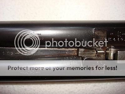

Was it ever determined to whom the Crossed Cannons Trademark might be attributed(L-C??)? I can't recall.
I believe the chicken scratching to be covering"
"Made of Best" over "Laminated Steel".
Cheers,
Posts: 12,825
Likes: 540
Posts: 12,825
Likes: 540
Or moreover it just may be "Made of Best" over "Crucible Steel" as see on the G. Defourny-Sevrin of Liege. The "Laminated Steel" stamp might be a stamp in error.

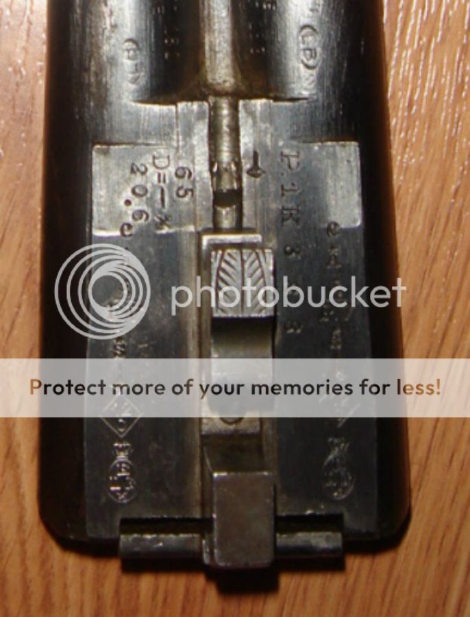

Originally Posted By: MattH
Hello All,
I have a 20ga. Belgian gun from another unknown maker or seller. The only clear identifier is this legend stamped on the top of the barrels: Paul Schraff Armurier Bruxelles.
I have been unable to find the name Paul Schraff anywhere so far, either online (including searching this board -- there was one old reference to a D. Schraff gun) or in any books/catalogs that I've been able to put my hands on. I'm not sure if he was actually a maker, or simply a reseller. Given the broad knowledge on this board, I thought I'd see if anyone here has run across the name before.
I'll post some pictures below. What you'll see is what appears to be Francotte action. Looks like their typical Knock-About. The gun has the usual Belgian proof marks and a date code for 1930. Serial number is 8455.
There is a mark on either barrel that is a pair of crossed cannons surrounded by the works "Trade Mark". I'm sure I've seen this mark somewhere before, but can't remember if it is a barrel maker or maybe a gun maker's mark.
Thank you all for any help.

Your shotgun is manufactured in 1930 by G J Defourny-Sevrin for Paul Schraff, Belgian "fabricant" of fire arms (Bruxelles, rue Royale,17 and Arlon, Grand Rue,57). Barrels of Lhermitte-Bruyninckx
