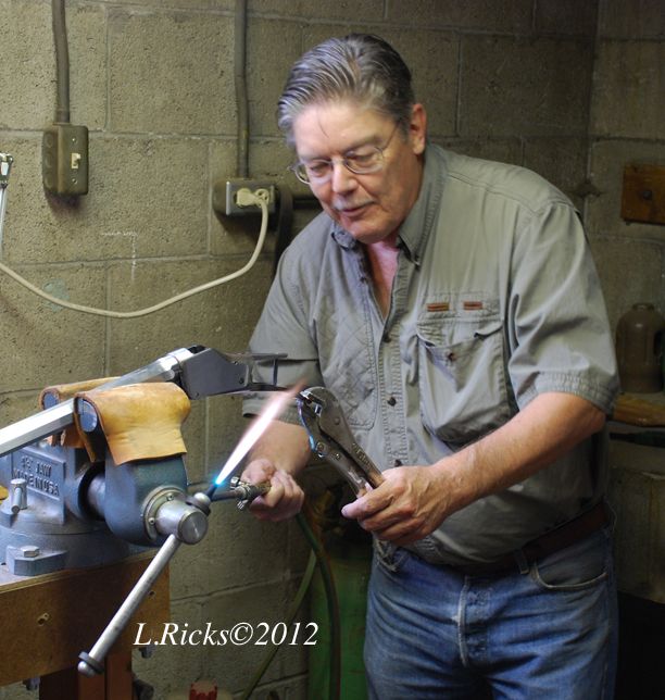

Steve is the guy holding the torch. His long, lost third cousin by marriage from Oklahoma Nick Hughes brought the High Wall project and did work. Nick is owner of J-S Machine, a quite accomplished custom metalsmith and a more that competent craftsman.

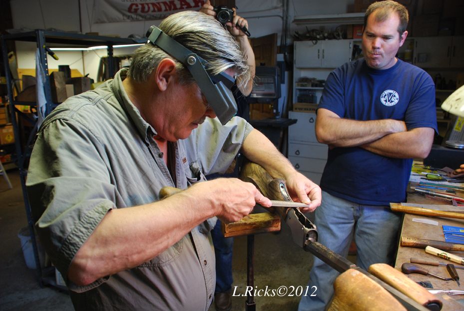

Rasping the grip to the finished tang
Robert beginning his first skeleton grip cap installation. Note the precision tool...

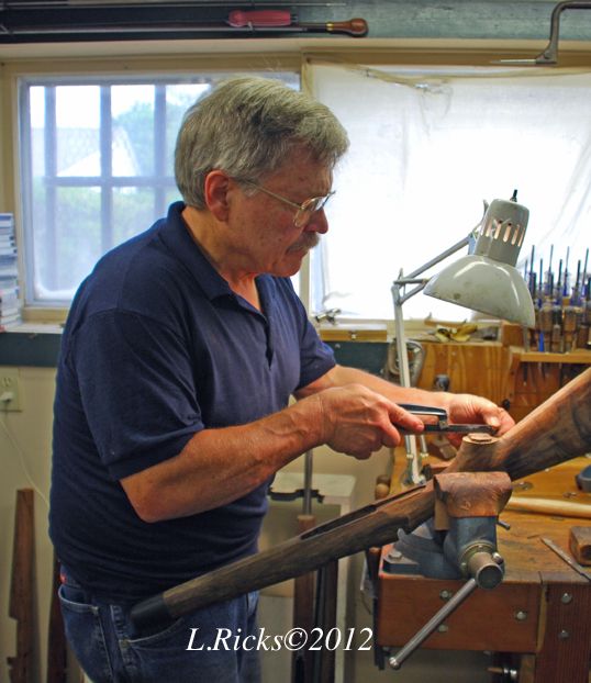

BTW: Robert's grip cap inlet came out very nicely, all done with hand tools, as was the focus of the Seminar.
Cap and inlet.
Using a scraper Robert made the previous day.
Another job well done...

Brent, I've found that the main key to a successful bend is to heat the steel to a red heat and hold it there while bending. Before the tang is heated it's often rather brittle, as you have seen. The factory bend does not begin until behind the tang's machine screw position and Bubba obviously doesn't know this, also Bubba apparently doesn't believe in heating/annealing the tang before and during the bending process.

Thanks for your support JD. I can be frustrating to post a picture of something actually in process and have someone question the methods based on imagination or hearsay. I've heard about bending jigs as well but have never seen one.
I have an original deluxe High Wall stock for comparison, but this tang was being bent to fit a pre-machined stock so a new cardboard template was made. It was compared to the original stock as well.
The tang was slightly under-bent the first time, partially inlet, then tweaked with a bit more bend and a touch of cant to straighten. Two heatings total, and plenty of cooling time afterward.
While I've made plugs to fill the multiple holes of a Win. 73 tang, I haven't found it necessary for a High Wall. In fact, clamping the "salmon tail", protected with a fold of copper sheet, lessens the possibility of heating and distorting the wood screw hole at the end.
Each Model Winchester or Marlin tang requires a bit different procedure for pistol gripping. Experience is the final word.
Steve
