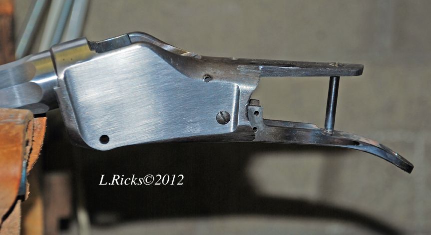

Interesting photo of bending the tang. I would have though that the rear hole would be filled with a fitted bolt in the rear screw position, and that you would mould it by clamping between blocks in a vice instead of just "tailing" it like it was a salmon.
Pretty interesting photos for sure.

The tang came out great and was completely inlet with tang bolt and wood screw installed. Nick also managed to get the buttplate inlet and installed.
There will be more pictures of the process on the website in a few days.

I've heard urban legends of folks who had fabbed such tang-bending fixtures but have never seen any of them or talked to anyone who claimed to own, have used or have ever even seen such an animal. Over the years I've bent several, as well as re-bending some of Bubba's efforts, and always found that 'tailing' it while using a hand-held template like Steve's was the best approach, at least for me it has been. The open access to both the top and bottom of the tang allows localized heating by the OA torch without the aggravation of having the clamping fixture suck the heat away from the area to be bent.

The low wall I have was bent in purpose-built fixture. And, I've bought inexpensive actions that were cracked or broken through that last screw hole, and seen one or two with a rather distorted looking hole.
