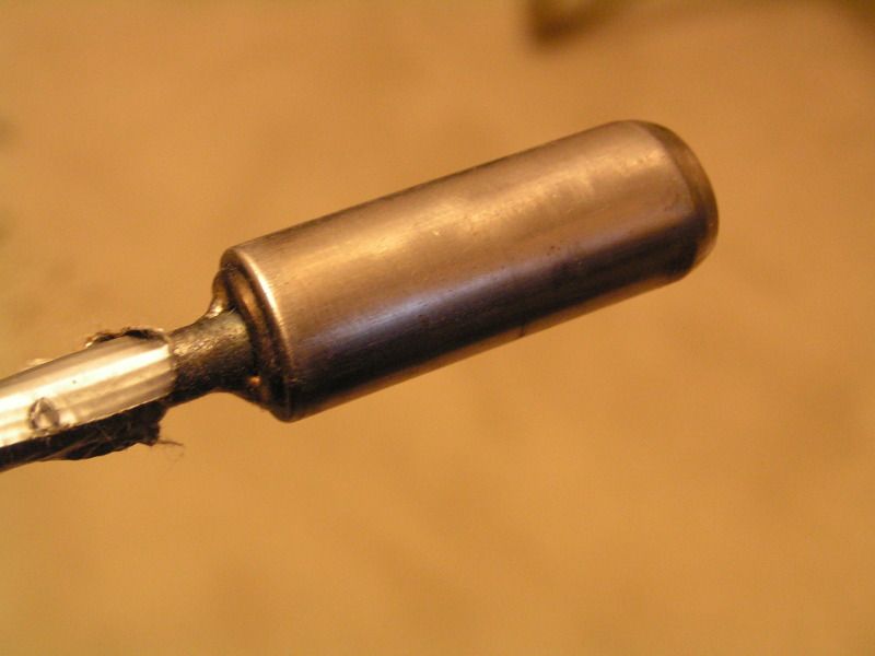

Gazz
This is a typical plug I've used. I just sand the nose radius with a belt sander and polish it with a hard Scotchbrite wheel.
