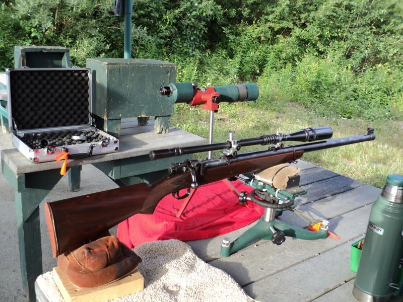

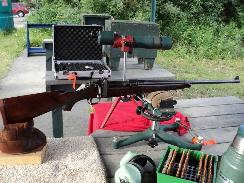

Great, I'll look forward to see how they shoot. If you need something to shoot for in the accuracy department I can drag this out. smile
Niedner barrel,30-06, 20X Unertl, armory stock reworked by J.V. Howe.

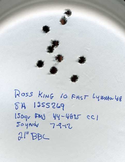

Ross King, I fired ten as quick as I could, I watched the first two at top and then let fly. Wood contacts the barrel about everywhere and has a barrel band sling swivel through the stock.
Just wanted to see how wild it would get.
