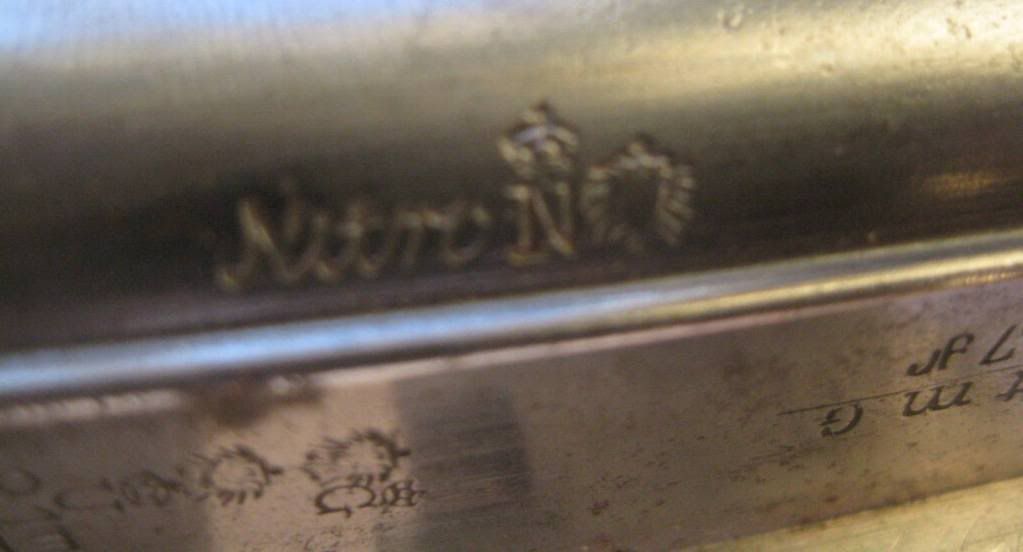

That is sufficient and confirms that um it passed thru the Zella-Mehlis proof facility. With a serial number like 19207, it would have been sourced from a larger Zella-Mehlis concern who in turn subed the tube work to Louis Kelber, one of the top tube makers on par with one of Belgium's best, Jean Falla. The tube makers were a very proud group and rightfully so as their work was the basis for the sporting arm. If the tubes burst on the 1st test, the tube maker had to replace at his expense. If the tubeset burst on the 2nd test then the tube makers & tubeset knitter accepted the blame. Then if the longarm submitted in the final state fails the proof test, then the whole lot of mechanics had to accept the failure and that along with compensation is the reason for the maker's touchmarks.

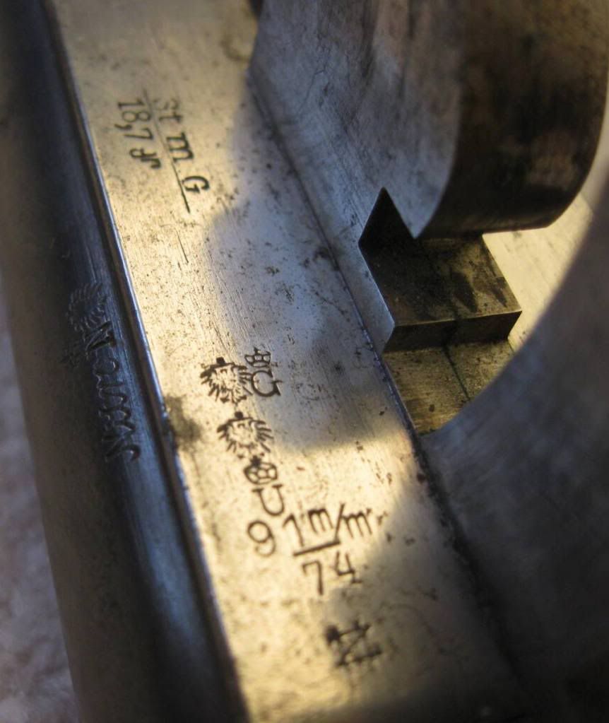

I took the gun apart just as mentioned. So here are the additional pictures....

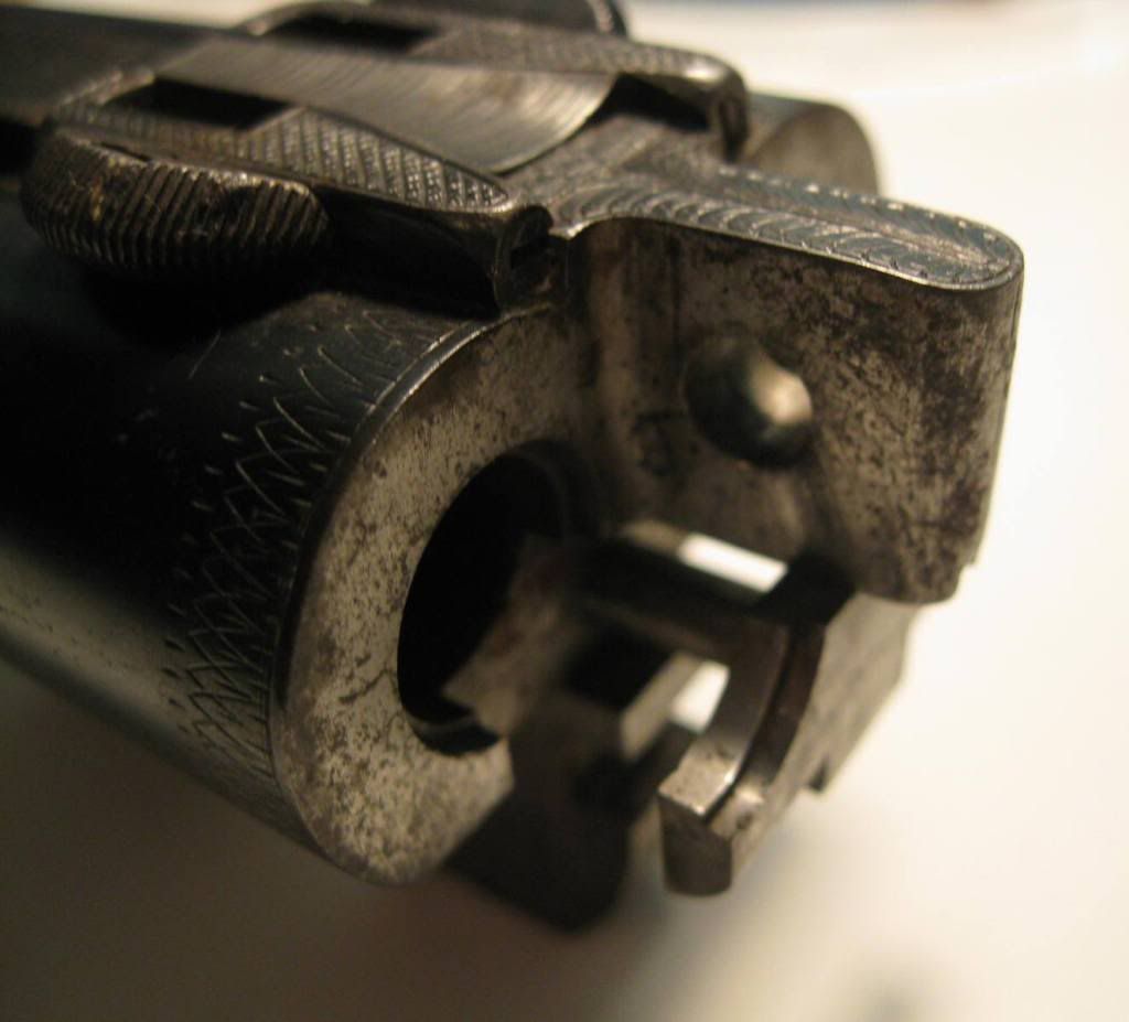

You've got a gem in 9.3X74R in possibly a chopper lump tubeset. Can we get an image of the end with the extractor out?

I don't know what you mean when you say the end with the extractor out? Can you post a similar picture to what you are looking to see?
Googled it...LOL...I see the extractor, but how does it come out?
EDIT: I've never felt like such an idiot in my life! Thanks again for the patience.

I had my fingers crossed for the owner Raimy that 9.3X74R would be the caliber. I agree this is a gem and well worth restoring.
If you go back up to the picture with the 9.1 It appears to be a chopper lump.

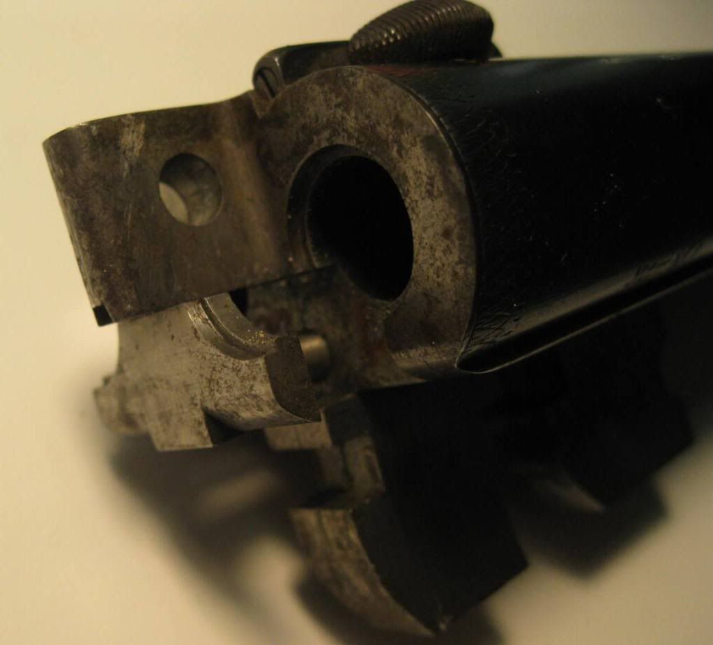

Ok, I got it...here is the extractor:
