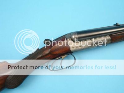

Joseph Jakob DR with permission use number 1152. Interesting on OWD's thread that a fella who indicates he is a descendant of Joseph Jakob noting Jakob was born in Bohemia in 1834 and that one of Jakob's daughter-in-laws was shot in the arm in the immaculately clean shop. Assuming it took him till age 24 to attain his master's brief pairs well with the 1859 date that some references give as the year he hung out his shingle.
