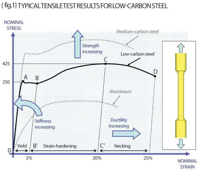

This is the explanation of steel properties when yielded.
The vertical axis of the chart is stress(load/force). The horizontal axis is strain (movement/deflection)
You can see the metal yield point where it takes a little dip, then all plastic deformation from then on serves to increase the strength until necking (thinning) of the test sample reduces the ability to carry the load.
