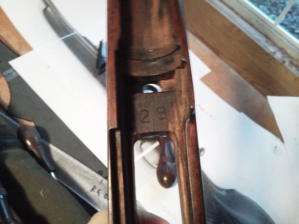

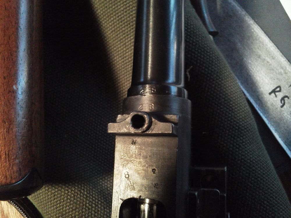

Mine is stamped, but well and neatly stamped. "S" in a circle. It was a clean barrel - didn't appear to be any kind of alteration to a military barrel. I don't know what sort of odd-ball, small lot work Springfield or Winchester or even Savage would be willing to turn out - I expect it was pretty free and easy. I expect if you needed a hundred or so barrels in 30-06 (or other standard chamberings) you could get them on relatively short notice, especially in the 30's when people were selling their dental work to keep food on the table.

Hey Dan -
Sorry - mine is #28. Stamped on barrel, receiver, and stock.
I could find no other numbers on it. The 28 is also on the bottom metal. Nothing on the bolt.

Ryan,
I think those are just assembly numbers and don't match the serial numbers. If the receiver markings are still on the gun, there may not be a Sedgley serial on it. When they removed the receiver markings they usually added their serial in the groove behind the sear on the tang (visable when the bolt is removed)plus on the back of the bolt handle. On those with the SA or RI numbers remaining, they usually added that number to the back of the bolt handle.
