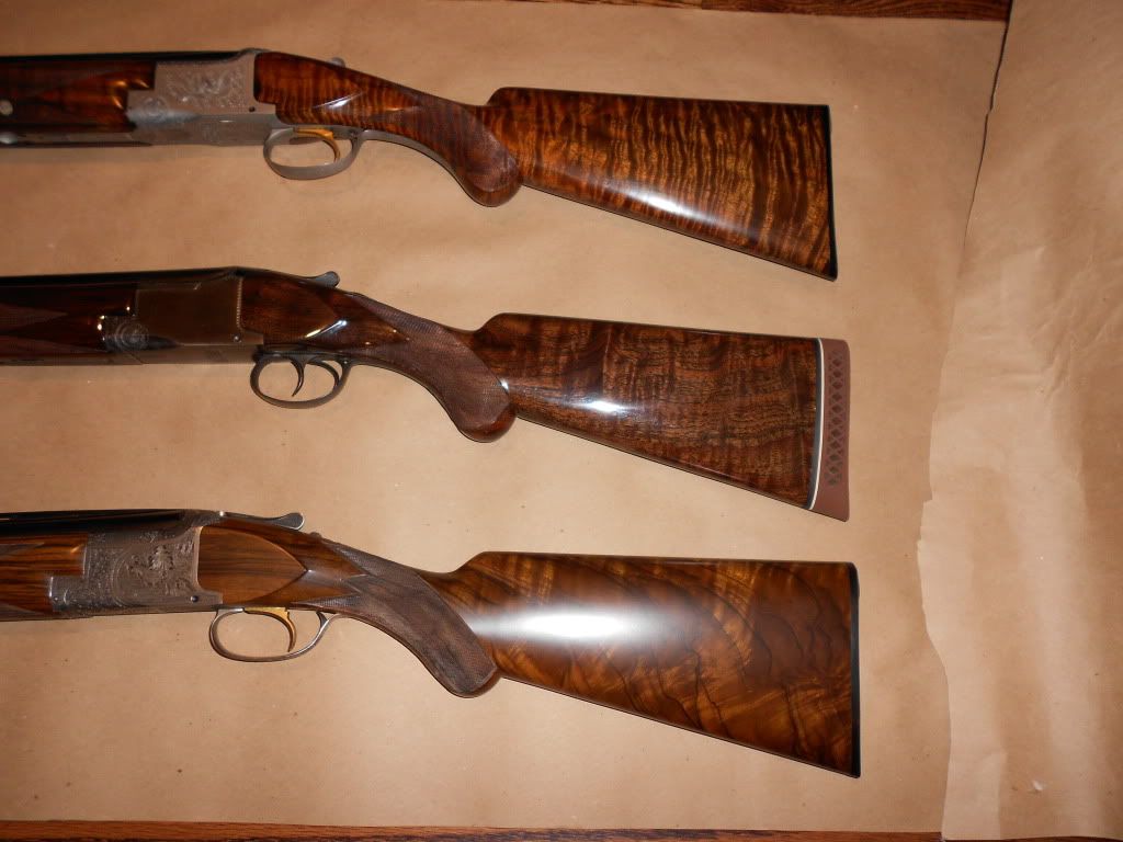

I seriously doubt if the first stock shown is quarter sawn. Take the buttplate off for a better look.
These days the only quarter sawn you get is the middle cuts of the tree as it is slab sawn.

When you consider the slab sawn middle cuts of the tree, there are differences between say the 2 or 3 VERY middle ones and one on either side of those, where the grain starts to curve around. Some people refer to those areas as 3/4 sawn. The first one shown is not quite there IMO. But actual technical description may even vary by geographical region of the country. I just stated what we say around my part of the country, yet the whole post was about the fiddleback to start with. When you get down to it, slab sawing messes up as many stocks as it lays out right, which is why I never used the method. I always went for layout, and any waste was too bad since I was concentrating on gunstocks and not lumber...Steve

Doug Mann's stock is feather crotch, running "up the limb." The crotch therefore ends up in the buttstock, and the grain turns through the wrist of the stock as it is actually the heart of one of the limbs which made up the crotch. It is certainly laid out textbook fashion. I see some crotch cuts running down the trunk, which I have found is more difficult to get as good a layout. (although on a .22 or other light recoiler, it might make it possible for the entire stock section to be feather.) I sure miss the old days of cutting trees--it was like searching for buried treasure! But the kind of work that will turn you old...Steve

Example of quarter sawn stock :
Matching right/left sides
horizontal grain through butt:

Fiddle back is amazing and one of my favorite wood attributes. Here is a 1932 Superposed with light fiddleback:
And a 1966 Superposed with amazing fiddleback (top gun in photo):

Originally Posted By: JDW
The picture of Quarter Sawn on Wikipedia in my opinion is not a good way for it to be done. To get the most quarter sawn wood, and the least, is to cut the log in half, then cut-side down and then cut 90 degrees to that.
A lot of wood is wasted this way, but for furniture that is the only way to go. White oak is most always quarter sawn.
The easy way to tell, like shown, is that the annual rings will be parallel to the sides, where as flat sawn, they are circular in shape.
This is incorrect, if you are referring to quartersawn. As shown with Doug's blank and the Fox, in quartersawn the growth rings are perpendicular to the face of the board/blank, not parallel.
