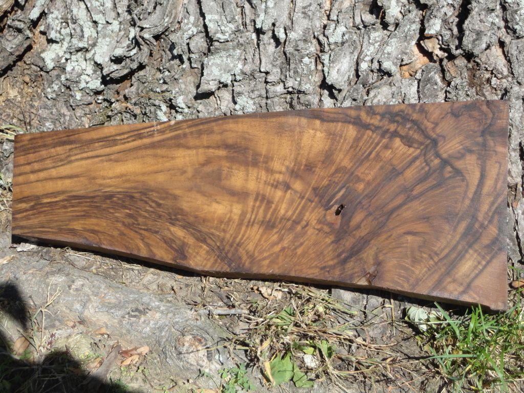

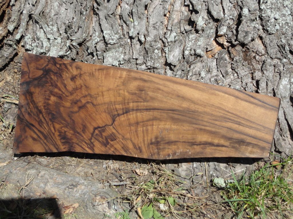

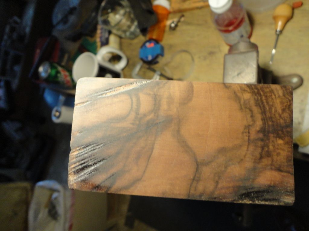

I'm posting three photos of a very nice piece of quarter sawn Turkish that I hope shows what "quater sawn" means. This particular piece is what I call feather crotch mainly because that's what I think it is. smile If you look closely at the end view you can see the annular rings that go from one side of the blank to the other. The two side views show how well matched this blank is from side to side. A blank cut "flat sawn" will have the annular rings in more of a vertical layout or at least some version of it. With a flat sawn blank the figure can either get better than what you see in the blank or it may get worse. Anyway here's the pics.

Doug, Very nice piece of wood! does it happen to be for sale? Bill

The picture of Quarter Sawn on Wikipedia in my opinion is not a good way for it to be done. To get the most quarter sawn wood, and the least, is to cut the log in half, then cut-side down and then cut 90 degrees to that.
A lot of wood is wasted this way, but for furniture that is the only way to go. White oak is most always quarter sawn.
The easy way to tell, like shown, is that the annual rings will be parallel to the sides, where as flat sawn, they are circular in shape.
