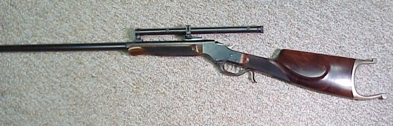

Why did you go with side extraction given a 12 o'clock ignition?
I'm not sure what the jury has said, if anything about top ignition, but it does interest me.
I too have the unobtainium hammer (short fall - ~1/8") and it is double sprung.

I thought that I'd leave the barrels ugly exterior as is, that would get some attention if it shoots at all well, when fired do they make that distinctive Bloop tube sound?
Very nice looking Low Wall, did you make the clamp on palm rest, I just found this yesterday in The Ideal Handbook of useful information for Shooters reprint... Look familiar?

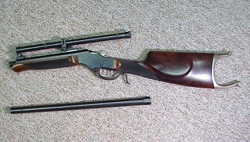

Well, live everything on that rifle, a couple of people made that palm rest for me. A wood turner made the wood out of a very heavy hunk of Sonoran Desert Ironwood. Another friend made the metal insert that is very similar to the one in your advertisement.
Once upon a time, I counted up the number of people that had a hand in this rifle and it was well into the double figures - and it's not even engraved. Our own JD Steele was the source of the action and some work on it and some advice as well. And the omnipresent Glenn Fewless and another buddy teamed up for the super-speed hammer made of unobtainium. And there were many other people involved around the country. It has a crescent buttplate to replace the small swiss with the situation calls for it and several different sighting mechanisms. The only parts I did were all the metal polishing and the barrel bluing and the wood finishing. It is, by far, my favorite rifle.

...and a lovely looking rifle too, Brent.
