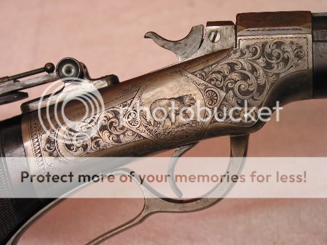

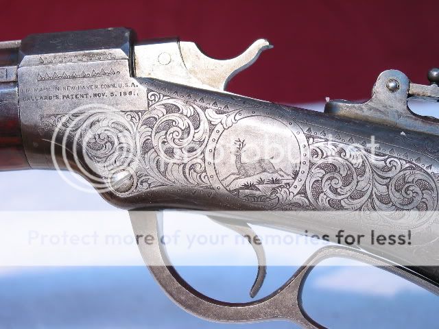

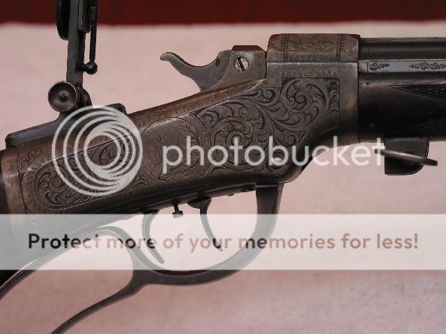

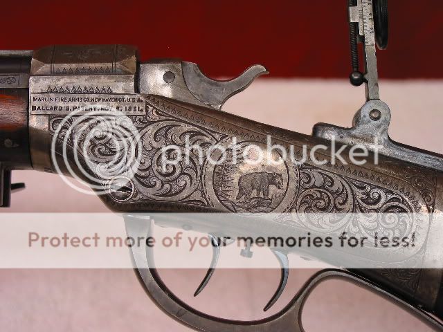

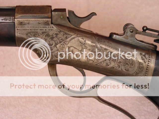

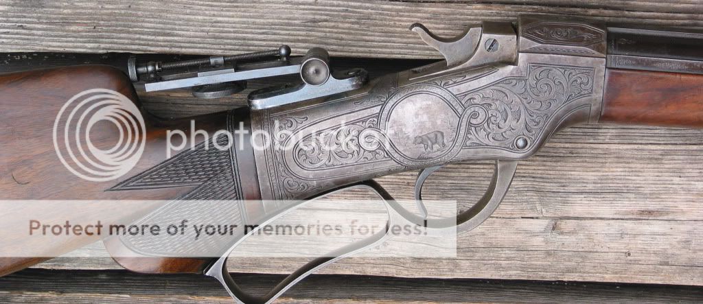

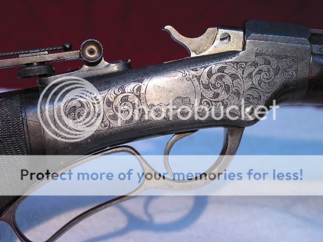

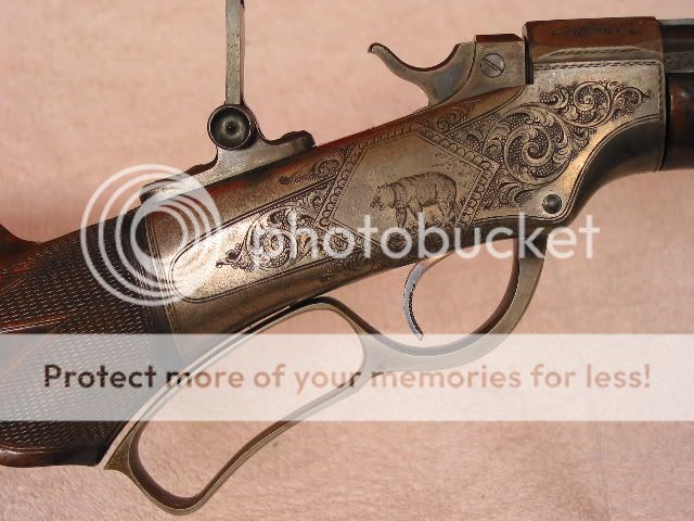

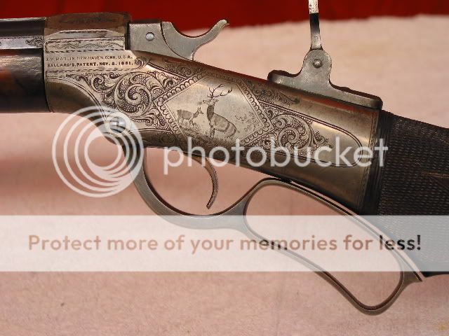

I am partial to vintage engraving. Here are some examples from Marlin Ballard rifles.

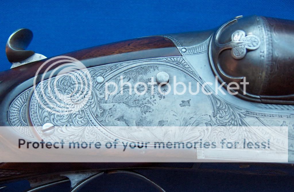

Whether you see it as old fashioned and stylized or not, I am very partial to the right lockplate on this 1886 AA Lefever:
