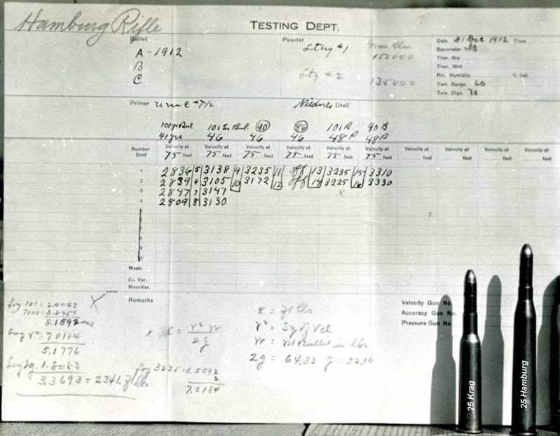

I hope you can read this, chronograph of Niedner's big 25-Krag with the long case. 48gr Lightning for 3330fps.
Found this, very interesting, my readings were not to far off.

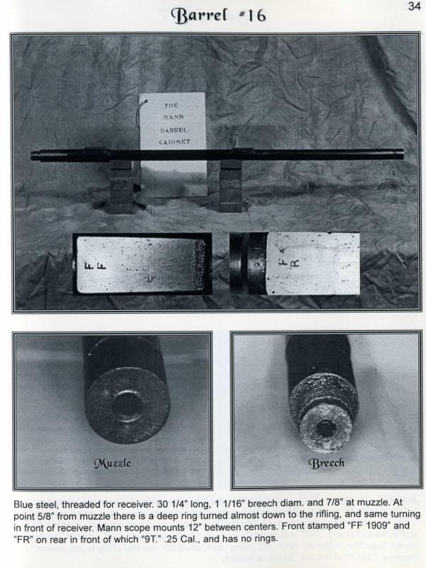

I've been playing with other Mann-Niedner 25's for some time now and this barrel is dated 1909, the earliest one I have access to.
Here is a picture of an identical barrel at Walnut Hill, the only difference is my barrel is also marked "F.W. Mann".
