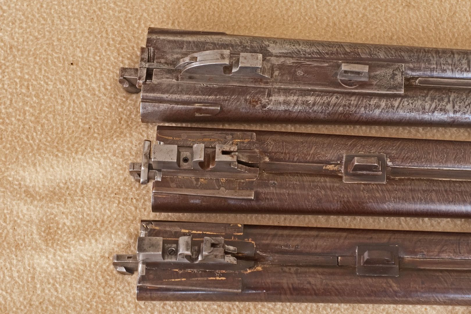

Dr. Bob, can you post some photos of your converted barrels on any of your guns. Thanks, Jeff

Posts: 580
Posts: 580
BALTDBL
We have kind of hijacked this thread, but its your thread.
From top to bottom:
Dangerfield and Lefever 10 gauge from Wm Green
Barber and Lefever 12 gauge from unknown
Barber and Lefever 14 g from unknown
