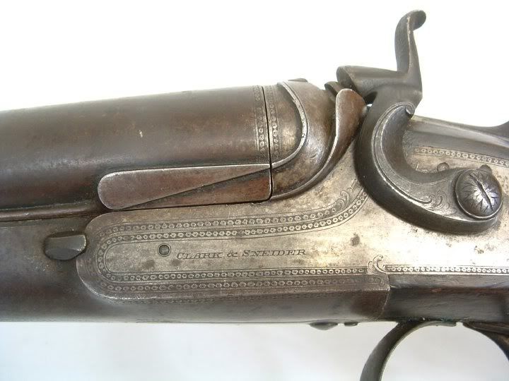

I find this interesting....top of the center rib is marked Clark and Sneider, Baltimore, Best Laminated Steel 1859.

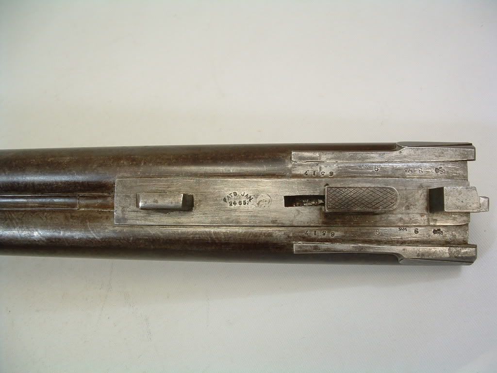

Posted photos finally...take a look. Appreciate your opinion....Jeff

English black powder proof marks on the barrel flats. Can we have a pic of the watertable?.
What makes you think it was converted from a muzzleloader?
Often muzzleloaders of this era have the bar-in-wood action, this one does not.
I think it is an English gun made in Birmingham. I dont think it was converted from a muzzleloader

Thanks Mike...let me see if I have a pic of the WT...it may have no marks...let me check. Absolutely...looking to get opinions on this. It was suggested awhile back....that it may be a conversion...so looking to get input on this early gun. Some believe the barrels are converted muzzle-loading barrels....Jeff

Looks like a conversion to me with barrel flats soldered on the the donor barrels. No Sneider Pat. locking bar on the receiver on this one. Nice sculpturing on the receiver/breech.
Also, the 6000 range serial no. does not seem to be in sequence with other Sneider gun numbers.

Jeff, I'd sure like to see the proof marks on other Clark and Sneider guns, if possible, please.
Is a gun converted from percussion if muzzle loader barrels are fitted to it?
Was the firm of Clark and Sneider similar to Von Lang and Detmold(?) and Charles Daly?
Did they actually make anything themselves? Just curious.
