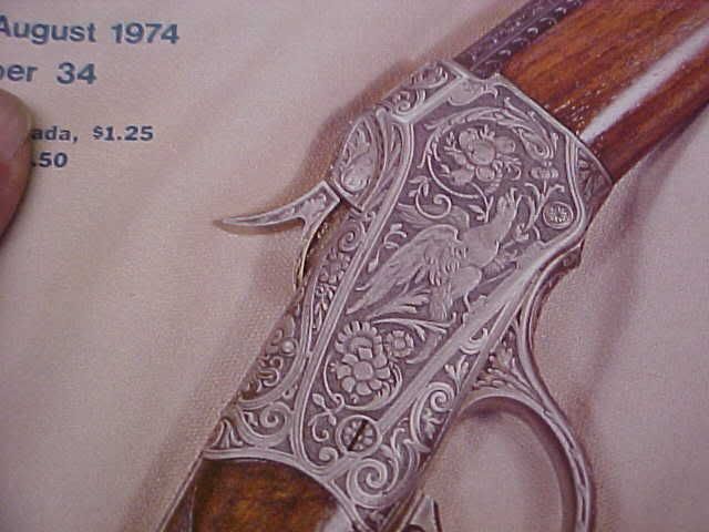

As has been pointed out,,take any of the old 'Masters' works and enlarge a picture of their work to this point and it reveals the jagged cuts and other horrors too.
They didn't work under sterio microscopes and other high magnification as is so common now.
No air assisted 'gravers to produce smooth cuts w/no facet chatter marks.
Magnification was always common, though some engravers did not want to outwardly admit to using any.
The style cut on the Winchester uses semi relief and modeling to produce an effect more than relying on line and/or dot shading that is most commonly seen now.
Punches of various shapes are used to push the metal into shallow relief shapes to produce shadow and light.
A followup would be to carefully polish out the shapes of the punch marks to produce a smoother finish on the vines, leaves, animal features, etc. But that wasn't done here.
Background is matted with small punches that punch a larger surface than a single dot. They are made to push down and matt at the same time a larger area. That background was probably removed in a random pattern with a single point tool. It's fast and convenient to get into the corners. In punching it down, it's leveled and matted at the same time. The punches are very tiny but work goes fast,,much faster than with a single point.
Some other styles of work are left with the randon single point background removed. Some is done with a single point cut in a parallel manner. You'll see that on Parkers and some Fox patterns.
Is it a one of a kind master piece? No I don't think so. But it's a nice looking job overall. The price?? That's up to the seller and buyer.

Here's the other low wall, with the same fine stockwork but a completely different engraving treatment.
The image is poor but it's easy to see that the effect is stunningly different. The anatomy, again, perhaps isn't the best but IMO it's A LOT better-looking than the Hallowell one.
Regards, Joe
The difference is the anatomy elements in the Hallowell rifle weren't designed to be "lifelike". They were designed intentionally to be elements of a scroll.
The appreciation of this effect is certainly subjective, but it does require talent......and it's not as if correct anatomical recreation was attempted and not achieved.

Many, perhaps most Germanic engravers seemed to draw their inspiration for animals and birds as much from heraldic bestiaries as from nature in the period we are discussing. The blending of fluid forms like scrolls into representations of animals that Grandview's sketch shows is very ancient; what we see here is the naturalistic ("lifelike") end of a spectrum whose other end is the Celtic and Scythian "foliate beasts". I agree that these artists weren't trying for anatomical accuracy; they had a different style in mind.
That said, some of the low-end German engraving of the '20s is really comic. I have a very useful BSW 12 guage SxS decorated on the bottom of the receiver with a duck worthy of Disney, not I think, an effect the Nazis intended. "Engraver sabotage" or just plain incompetence?
