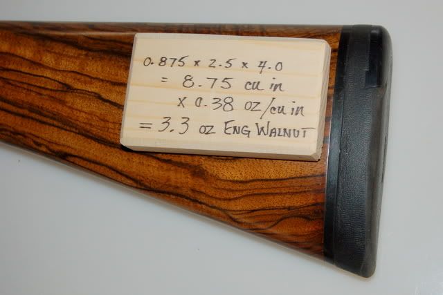

Walnut weighs between 30 and 38 lbs/cubic foot. If my calculator is right, a cubic inch of walnut only weighs between ,25 and .32 oz/cu inch. To get 3 oz. out, you would need to bore out about 10 cubic inches. Doubtful.

I weighed 3 fancy English walnut forend blanks and came up with an average of 0.38 ounces per cubic inch.
I've removed as much as 6 ounces. As I said, depends on the stock and how determined you are.

Somewhere I am not following your math. Is that 4 holes 2˝" deep by .875" diameter. If so I get about 6 cu/in of mat'l removed for a weight reduction of about 2.3oz. It appears you have just multiplied the dia of the hole by total depth. Area of a 7/8" hole (.875) is .6013 sq/in times 10 inches of hole . You can't just multiply the dia of the hole by its depth to get cu/in's it takes the area (πR˛ or πD˛/4) of it times the hole depth.
Think rectangular cavity....actually 3 holes, 7/8" diam, 4" deep with webbing removed between the holes and corners squared up. My math is on the mock up; a rectangular block, 2.5" wide x 4" long x 7/8" thick, equals 8.75 cubic inches, I hope blush
....a bit larger all aound than a deck of cards.
Real world, the bottom hole would be smaller and angled up parallel to the belly line. Not a rectangular cavity, but even larger volume if need be.

Following now. Those dimensions do indeed come up to 8.75 CuIn. Your math is spot on. For some reason I just had a mind set that you were just drilling holes, which you didn't say at all.
