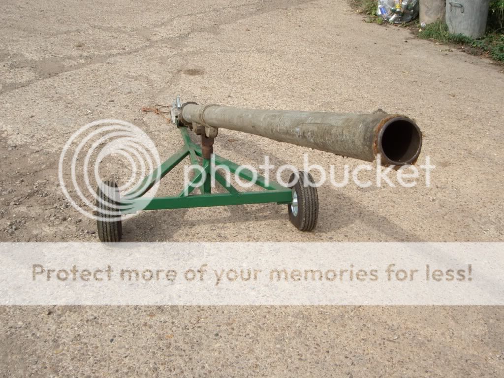

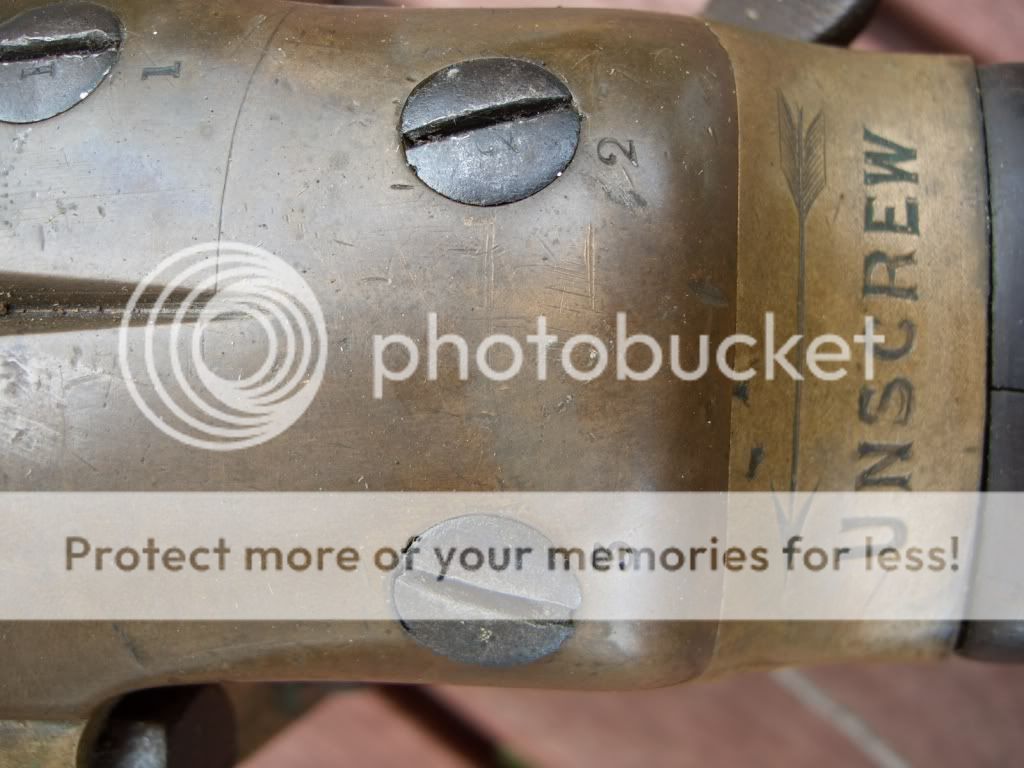

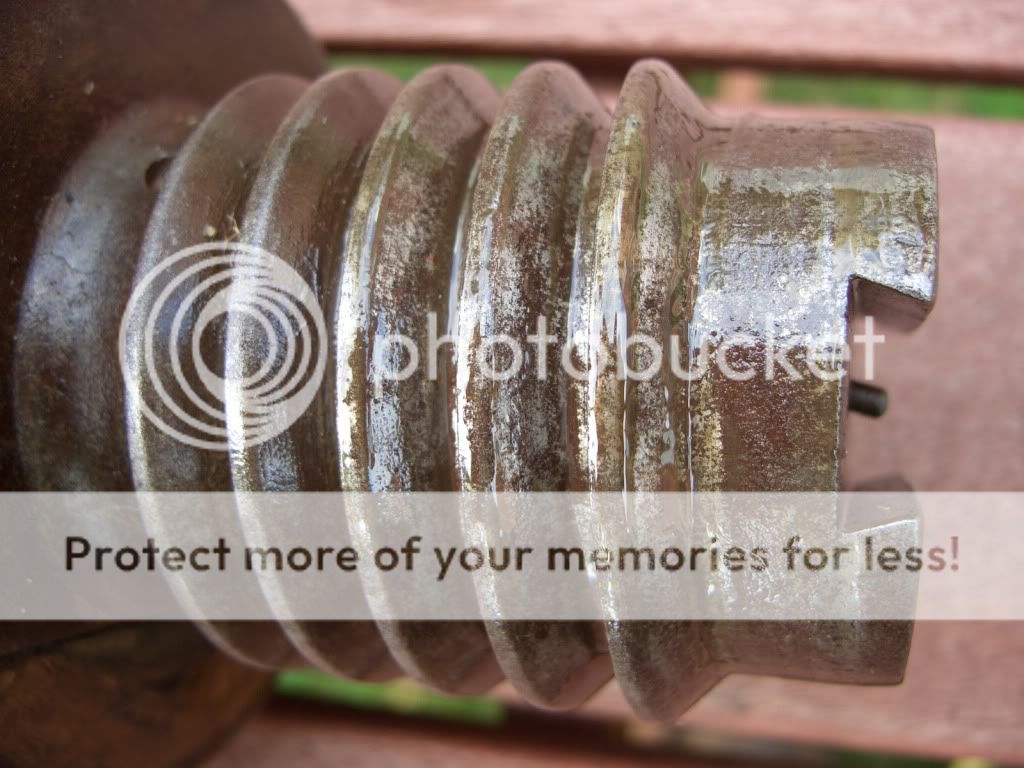

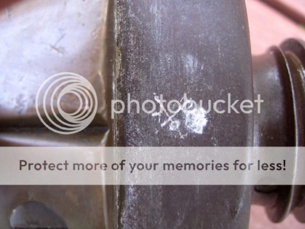

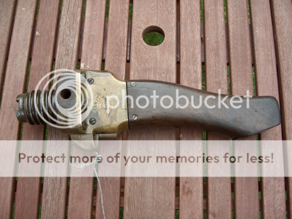

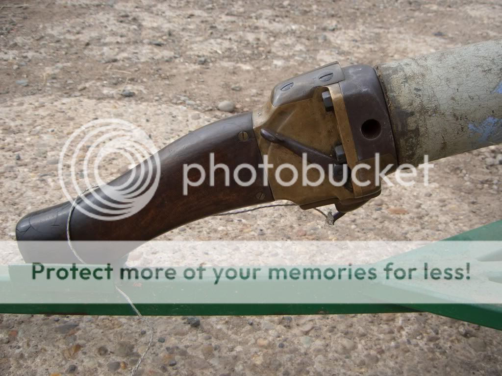

Here are a few detailed photos of the punt gun. Any suggestions re it's maker would be of great interest. It weighs in at just under 1 cwt, 9 ft long, 1 13/16" at the muzzel and 2" chamber. I had 3 cartridges made. Using what information I could find and using the old formula of 1 oz of shot 6 lb of gun I use 18 oz of shot and use the same measure for the coarse black powder - which works out at around 3 oz.
The chamber has a 10 thou taper and the dovetail for the cartridge head has a 5 thou taper to aid easy loading. From the chamber taper we assumed it was made for a brass cartridge rather than a paper one - they seem to work OK. I use a .38sp case loaded with fine BP to act as the primer - it has never failed to fire first time as yet. It is non rebounding so you have to half cock the cocking leaver to insert or remove the cartridge. The barrel is covered in shrunk on canvas painted grey - I guess to protect it from the salt It's a great bit of fun.

That is a nice gun for certain. Do you do much punting?

John,From the photos of your punt gun[A Breech loading Stanchion Gun] one can see that it dose not feature the sliding breech design patented by Tolley.
The breeching is similar in design to that invented by;
Captain G.Gould,Mr Henry Holland and Sir Ralph Payne-Gallwey.[Perhaps Britains most famous wildfowler and punt gunner]. Ultimately this design was patented and made by Messrs, Holland of Bond Street.A detailed drawing of this gun is found on page 484 of Sir Ralph Payne-Gallwey,s book,"Letters to Young Shooters",Third series,published in 1896.
The Black powder proof mark seen in the photo is of Birmingham origin.The mark is indistinct and could well be a Ketland proof mark. If this was the case,it could indicate the possible conversion of a barrel from A muzzle loading gun to breech loading.
On the side of the action away from the cocking lever there appears to be some worn engraving.Could this be a makers name or patent number?
One interesting feature of the gun is the use of a buttress thread on the breech plug. This type of thread is not seen in the drawings of the patent gun refered to earlier.
Should you ever wish to build a punt, design details are to be found in Sir Ralphs book.

It's a great shame there is no makers name. As you can see it is well built and the action has a very smooth click when cocking. They have taken the trouble to number all the screws and to put a taper on the dovetail is a nice touch.
The proof mark puts it at pre 1904 as far as I can work out. Those are the only two marks I can see - no load, barrel dia or chamber - no nitro proof. These marks could be hidden under the canvas covering. I guess all be can say that it is post circa 1860 (centre fire) and before 1904. Unless of coarse anyone knows any different??
