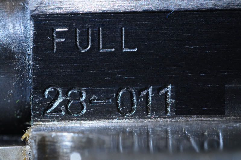

Brian asked what I used to take those pics of the Parker Repro watertable and its markings, so I thought I'd start a thread on it and some other pics I took recently.
I've been having fun with my recently acquired second remote flash when taking macro pics and thought I'd post this.
With the repro barrel pics, I used my D300 Nikon, a 60mm Micro Nikkor, the built-in flash, and two SB800 remotely trigger flashes arranged as needed to get the light right. For good detail, I put both remote flashes on the same side of the camera at about a 45* angle or steeper. This casts a shadow on stampings/engravings so they show better in pics. Also, if using a built-in flash, I always make sure the flash doesn't bounce straight back off the subject surfaces to cause glare. An angle of about 15-20* will be plenty to make the glare go away.

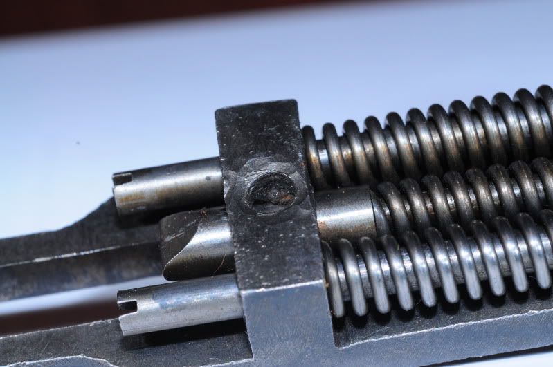

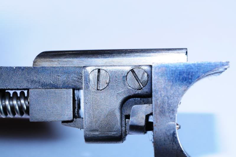

These pics of my forend iron from a 410 NID really were the first time I'd used two flashes in addition to my built-in flash. Same camera and lens as above. I was trying to capture some of the damage from a couple stripped holes and also the overall correct assembly. I think the lighting really caught the buggering up from a hammersmith pretty well. I'm in the process of repairing that, but that's another story.
I thought this last one caught some incredible surface detail. I played with the flash/camera angles until I got this.
So here's the basic camera/flash setup. You just play with the flash/camera angles like billiard shots, until you're happy with the results. And with digital photography, you can get the results instantly and change the setup to correct it.

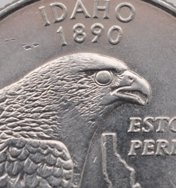

Here are a few pictures using an old Nikkor 28-85, that can autofocus with the D90 but in Macro (28mm only) you have to manual focus. The lens was approximately 2" from subjects.
Naturally the pictures were cropped. The actual size of the bill is 13/16" long x 5/8" high.
I was using a point and shoot for some time, but got back into SLR shooting with DSLR's. You are able to get much better photos.

JDW, The Idaho State Qtr upset a bunch of folks here in the North part of the state. The Birds of Prey area is a short distance south of Boise. Many folks up here thought something representative of the whole state would have been more appropriate. I drug a couple of them out and I certainly can't see the detail with the naked eye that you show in the photo.
