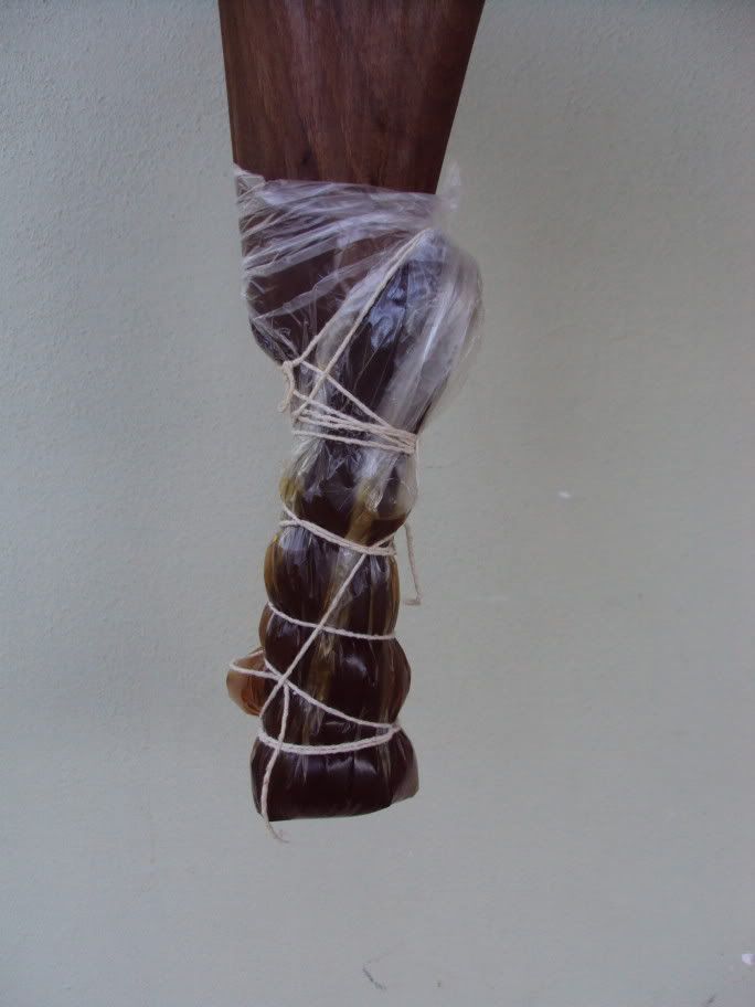

Hi kstt,
I tryed the plastic bag first to be shure and it works with the kind of plastics we have here.
You do not need much acetone for a stock (less than 1 liter) using my way, I leave the stock for one day and then change the bag and acetone.
The picture is from my first try. As you did, I found the line.
Then I used a bigger bag.
Martin
