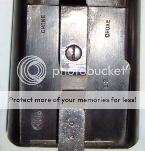

Heinrich Barella sidelock flats
Paris proofed double with the next rung of proof effort with tubes by Leopold Bernard from Littlegun's site:
http://www.littlegun.be/arme%20francaise/artisans%20a%20b/a%20bernard%20leopold%20gb.htm
To me what's interesting is that in comparision what location/position the marks hold. I haven't found a similar French stamp to that near the breech end of the Bougnet tubeset, but everything else seems to fit as far as a French made tubset, although I haven't found a maker to attach the stamp forward on the flats.

Not the same encircled stamp on F. Matsak's #30( http://www.doublegunshop.com/forums/ubbthreads.php?ubb=showflat&Number=145734&page=1 ) but similar crown(eagle??) as the stamp forward on the flats near the number "6095" and I don't see a "ML" on the H. Barella.
Heinrich Barella flats
