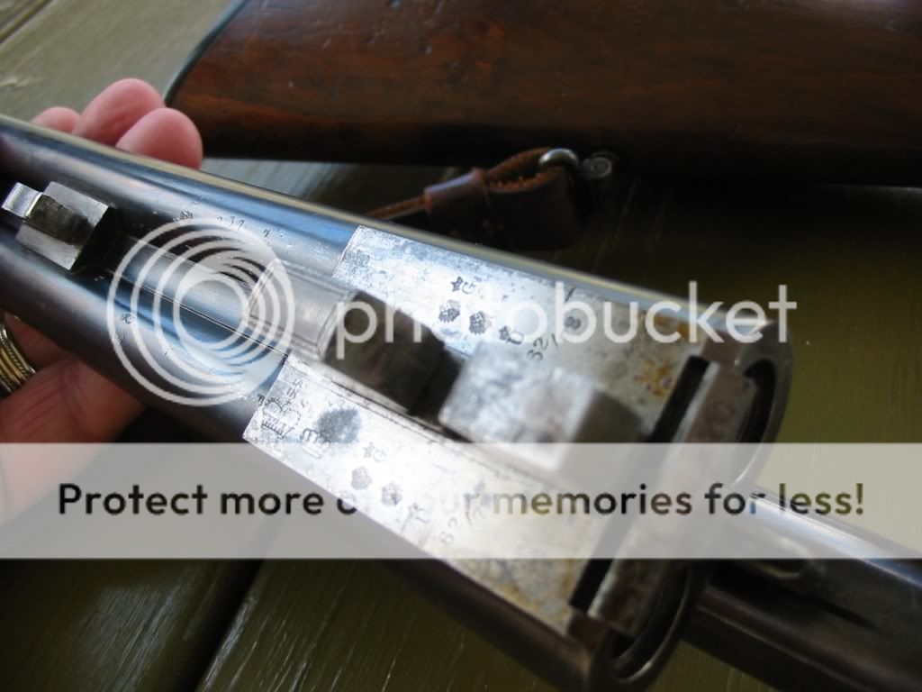

Ah, a nice little puzzle on a Sauer clamshell 450 with Wilhelm Kelber's script initials on 3 Ring Krupp steel tubes. Now crowns though. I'm curious if the "875.25" on the lower rib is a data string. Probably toward the end of the clamshell era.

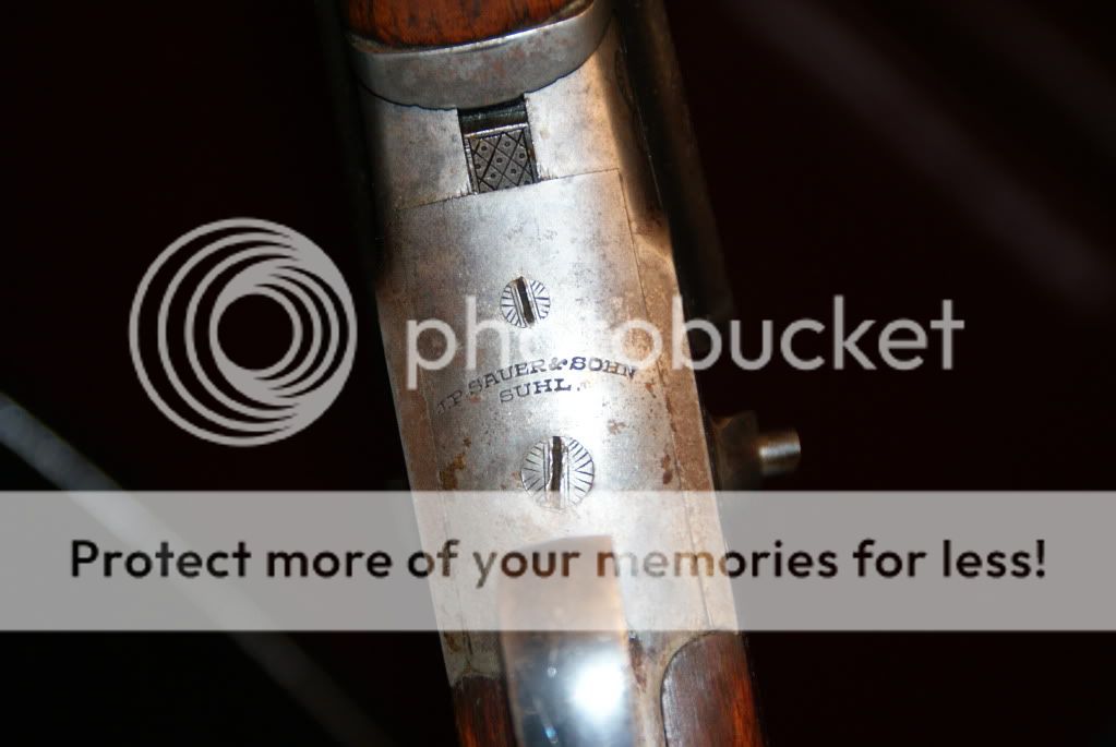

These pics are from a 1908 Model 8 SN 143XXX two clubmen one crown. Any ideas about what the H? signifies? Any help would be appreciated. Other photos are at [url=http://i1044.photobucket.com/albums/b443/Culitbob/J%20P%20Sauer%20and%20Sohn][/url]
Bob

The "H" is going to be the last name of the mechanic that either worked the action or filled the frame. Hard to say with just a single initial but it could be for one of the Hengelhaupt boys, one of the Helfricht folks or some other craftsman in Suhl with the last name beginning with a "H". I don't think it would be for Heym, but the possibility exists.

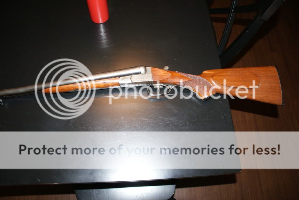

Woodsrunner38's hammer double with what looks to be a script "H" on the forend lug with "SS" on the base. After starring a bit and rotating the image the "H" now looks to be a script "L".

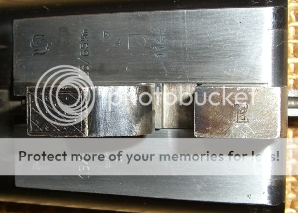

No large or small crown on the 1944 boxlock but it does have an interesting stamp of a "S" in a shield on the underside of the right tube.
