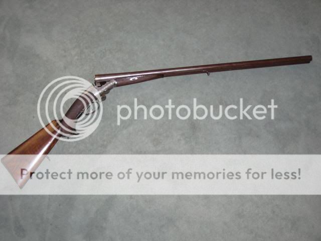

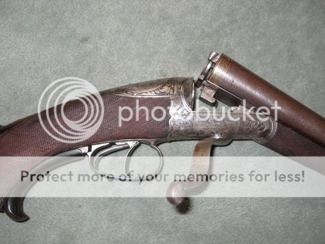

An elderly lady gave me an old double gun. It has shotgun barrels on it, but it appears more like a double rifle.Maybe the rifle barrels got lost. She said her husband was a physician and ended up in a German village behind the lines. They watched out for him and he took care of their medical needs until the war was over. They gave him this double as a gift of appreciation. It remained in their closet until she gave it to me.
It has a popup adjustable peep sight, adjustable triggers, rifle cartridge holder in the bottom of the butt,and is highly engraved. Hubertus is engraved on top of the receiver. It has boar, deer, and fowl engraved on it. The trigger guard, buttplate, and break open release is horn. The barrels are Krupp steel. Any hints to what I have?

Lefaucheux or Collath action of some type, possilby a Treff action(is "D.R.G.M. & Treff" atop the frame?). May have a grip safety. Immanuel Meffert had the trademark "Hubertus". Take some pics of the flats and post them especially the area from the flats to the forend lug.

Butch,
I believe you have a Meffert. It should be marked "Hubertus Gewehr 32200". The various models (as of 1911) can be found on pg.353 of the "ARMS OF THE WORLD-1911" catalog -- a reprint of the ALFA catalog of 1911. There is no listing in that catalog of either cape guns or double rifles.
If the barrels have a 'doll-head extension', it is likely a higher grade. Good pictures of proof, and other marks, would be helpful.

Some more photos
I hope these help. The last photo is the bottom of the butt stock and it is a cover for rifle cartridges, not 16ga. shotgun shells.

At first it's a little difficult to believe Meffert was still producing the Hubertus Gewehr 32200 in 1931, but here's proof. Any chance of a pic of the area between the proofmarks and the forend lug? I'd say it is a Treff action with the strikers contained in a metal block and that is why the cocking indicators are so far aft. With the cartridge trap and the German stecher - single set right trigger, I'd say there was a set of combo tubes. The triggerguard bow looks to be a grip safety. Nice depiction of Hubertus and a stag with a cross on the top of the receiver.

Raimey,
I hope these additional photos help. Oh, by the way it has 2 triggers. If you look close at the photo you can see the other at the back part of the trigger guard.

That's the pics. The Krupp tubes were sourced to Wilhelm Kelber and I'd guess Meffert finished it. For some reason, some like Axel Eichendorff(born just after WWII and lives there as a forester I believe) think the heart shaped "WK" notes that Wilhelm Kelber fitted the tubes. But until yet I don't subscribe to that thinking because I think it was more of a forge mark and that the script initials "WK" closer to the forend lug would note the fitting task. Take Louis Kelber for example. His forge mark is a an encircled(jagged) "K" and many tubes in Austria/Bohemia/Germany bear this mark. When he contributed additional effort, one sees the script initials "LK" closer to the forend lug. Why would Wilhelm use a reverse method in order to recieve compenstation?? Are there an initials on the tubes close to the lower rib near the forend lug? Yes, it has 2 triggers but the right one looks to be a single set. Push it forward and see if it sets.
