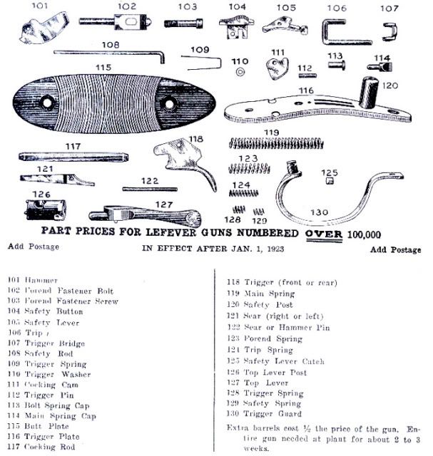

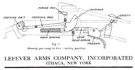

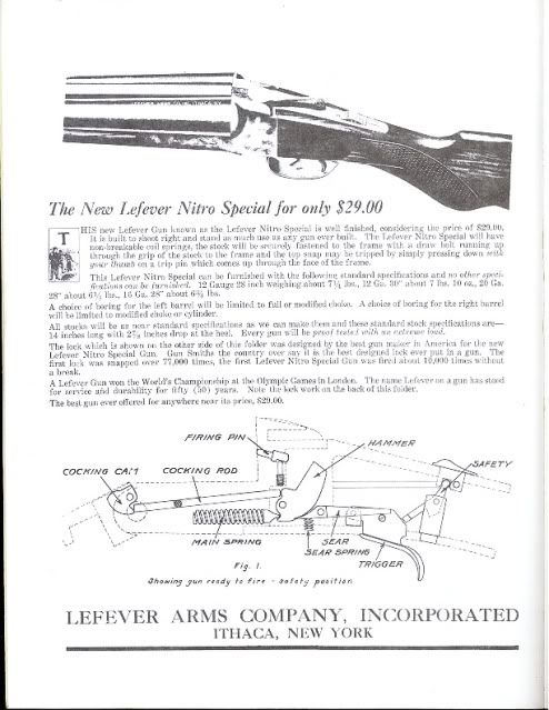

Virtually all my gun books are packed, but it seems I recall there may have been drawings or photos of the guts of those guns, either in Walt Snyder's Ithaca book or else in McIntosh's book on American doubles. Maybe both.

Here are some pages to help with the NS.
