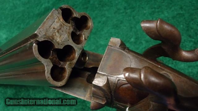

Something different ? You'll have to go some to get by this sidelock pinfire 6 barrel gun.
