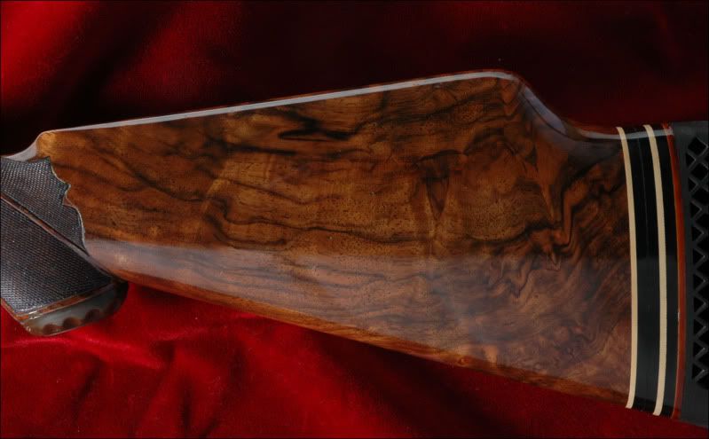

Drew and Daryl, Thanks for the info. The reason I ask is that I have a neat Lefever sidecocker, SN 6524, with a Monte Carlo stock. The stock has unmistakable Lefever styling. Since the table puts the gun around 1882, I'm guessing that the owner sent it back to Lefever Arms in the 1890s to have the Monte Carlo stock put on for trap or live bird shooting. The dimensions are really high. I'm going to shoot it tomorrow to see where it shoots in relation to where I look. I'd post a picture of it, but my computer and Lefever pictures are in the computer hospital.Thanks again.
Rich
Posts: 532
Posts: 532
Daryl & Drew,
My computer just got back from the hospital. Here is a photo of my sidecocker's Monte Carlo stock. [img:center][/img]
Rich

Rich, there are similarities.
