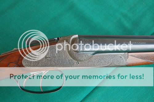

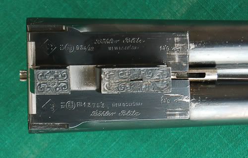

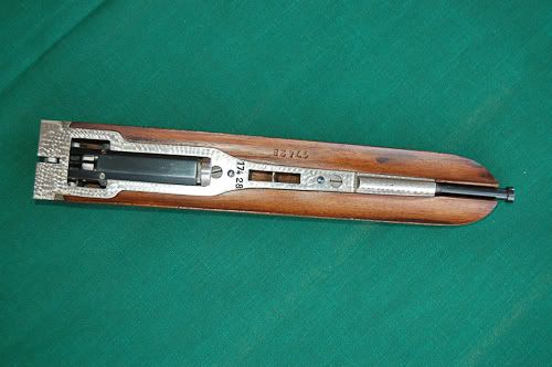

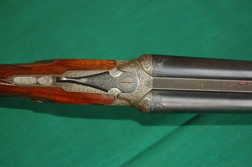

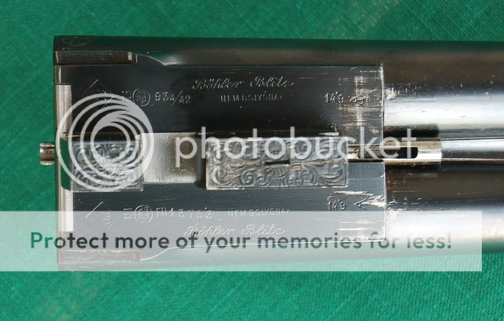

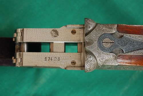

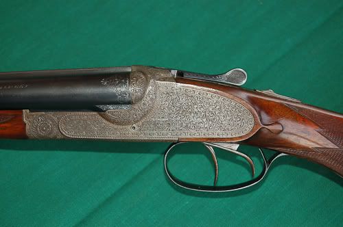

I bought a very nice 20ga SxS today. Only names on it are Budapest (I know where that is) and Fegyvergyar which may or may not be the name of the builder. Gun's proofs show it to be Hungarian, proofed in 1942. Unusual configuration in that it is a sideplated boxlock but with reinforced shoulders on the action and a Purdey style 3d bite. Someone really wanted this gun to last. It has Bohler Blitz barrels, and an ejector mechanism mounted inside a metal cylinder in the forend. (Haven't seen ejectors like this before.) Full coverage scroll on action and first couple inches of the barrels. I bought it based on the quality of the worksmanship I saw and the great barrels which are perfect with hand filed rib. Stout enough to be a great live pigeon gun but in 2.5" 20ga? If you know how to pronounce the name I would appreciate a phonetic assist? Any feedback on the builder would especially be appreciated.

ellenbr, It will be a while before I can post a photo of the flats, but I can tell you pretty precisely what is there if you would like. Email me at jvlape@cox.net. The marks are absolutely normal for 1942.

Ellenbr, the steel for the barrels is Bohler Blitz. That is found on the barrel flats. The ejector mechanism is the one described in the Frommer patent. Haven't had time to read the rest of the patent yet, particularly interested in the two brass screws in the action flats and whether the third bite is also described in the patent.

elenbr, the guns listed on tradex all seem to be utility guns as King Brown mentioned earlier, and in 12ga. I suspect they are post war guns and cranked out with little care. Aside from the obvious differences in engraving and finish I suspect the quality is higher throughout as it was made before the commies took over Hungary. They do not seem to have the top profile associated with the 3d bite either. I know I have seen a lot of guns with price tags about 5 times what this one cost me which aren't as well done.
Be interesting to know more about pre war models from FEG as they obviously had a capability to build some very nice guns.

The ejector device is the same as yours. I don't have snap caps for it to check whether the ejectors are selective or always fire in the same order. However the patent states unfired shells will not be thrown from the gun so that implies selective ejectors at least as patented.

Photos added

Jerry,
Yours is by far the nicest Hungarian double I've seen, my congratulations.
There is a number of plain grade post war Feg BLE doubles here in Slovenia and they have an excellent reputation as utility guns.

The ejectors are selective and precisely timed to drop the empties exactly side by side about 8ft away. Opening the fired gun is easier than the other quality ejector guns I have. It throws the top lever home with quite a positive snap on closing too - again without forcing the action closed.

Jerry thinks there is a "K" on the forend lug. My 1st thought was György Kirner due my thinking he worked at FEG and with Frommer but this is from memory and may have been a dream. I have to make more and better notes. But Rudolf von Frommer married Leoine Kornfeld(1874 - 1950) and I guess that to have been in the 1890s. So if one of Leoine Kornfeld Frommer's nephews decided to follow Rudolf von Frommer in the gun trade, it could account for the "K". I don't have a specific name but will continue to search. But Rudolf von Frommer was long gone by the date of proof of Jerry's example.
