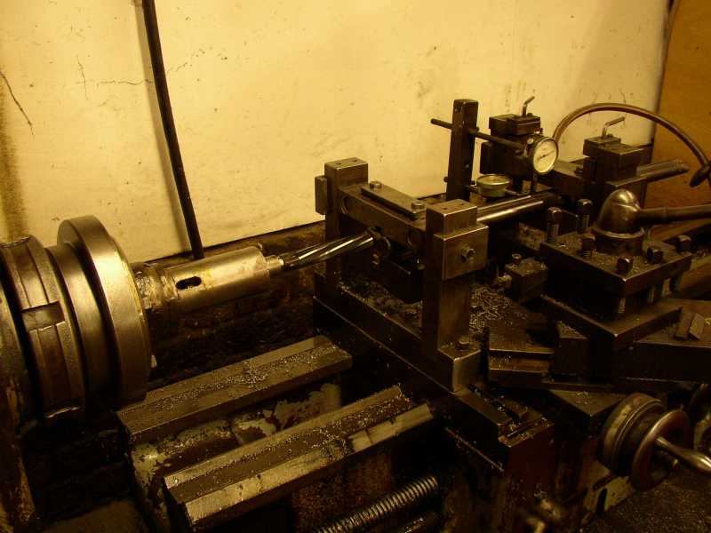

Here are the barrels being bored with a special boring tool. They are held in a jig to ensure that the new tubes are true to the original.

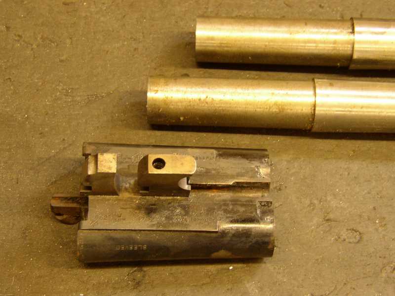

The monoblock has now been cut off to length and is ready to have its tubes inserted.
Another view.

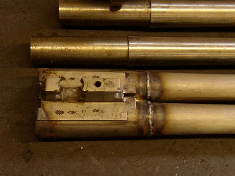

Once the tubes have been inserted, they TIG welded at the breech face....
...and at the joint.

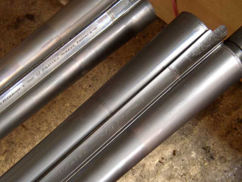

Here are some fairly typical soft solder ones part way through the blacking process (sleeved by Westley Richards in the '70's).
Here are some TIG sleeved barrels that we had done at a similar stage of blacking. Note the band of welded material.
Interestingly, while soft solder joints often get more apparent with time, TIG welded joints tend to disappear over time.

Arguably there is a risk of cracking in TIG process if the barrels are not properly normalised after welding.
Also I have come across many soft solder sleeved guns that are loose in the joint. This should not be a safety issue but accelerates the appearance of the joint as a silver line. It is only really detectable at the breech face where under magnification one can see oil bubbles being blown when you flex the tubes, similar to the test for loose lumps.

I found the same to be true when I TIG welded my tubes in a LC Smith conversion sleeving job. There's enough carbon in the barrels to harden the heat affected zone of the weld and it self-quenches from the cooling because the barrrels were cool. I had to normalize before filing.
