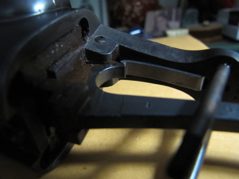

Return spring is in. I should take it out and break a few edges, polish and blue. I was very lucky to get it from Mike Del Grosso in Wilmington DE. For five bucks a much better deal than the "we could care less" treatment I got from Brownell--that's BROWNELL, BROWNELL, BROWNELL, the folks with no specs on a smith's spring kit! But I have another spring on the way from a member here and will probably send it back as I think this one is pretty close to the original. Had to lap a 1/16" plus a smidge from the width and take the ball end down about half. I actually did lap off the excess width on wet or dry 120 grt and cleaned up with 220 and 320 contacted to a couple of "strops" of tempered Masonite. I really didn't want to take a chance of cooking it on a dry grinding wheel or belt sander. Frame and trigger plate have been degreased now and look a bit better and work a bit better with Ed's Red working it's way around in there. Stock in process but no photo until I get a roundtuit!

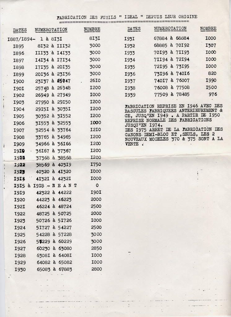

Unfortunately I have no serial nºs and production dates for Robust doubles.
I have a picture of a paper with serial numbres for Ideal guns but I do not remember where I found it.
Thanks
Martin
Not sure where I found this....

JC,
This is the paper I was talking about, thanks Pete!

Pete and Martin,
I posted that list some time ago. I got it from a French Idéal amateur.
Thank you all the same.

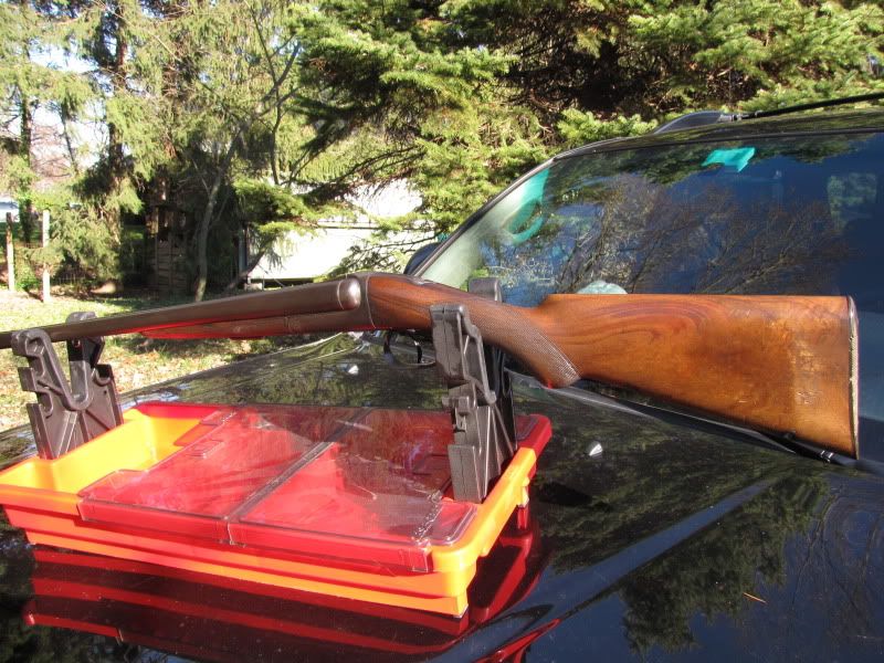

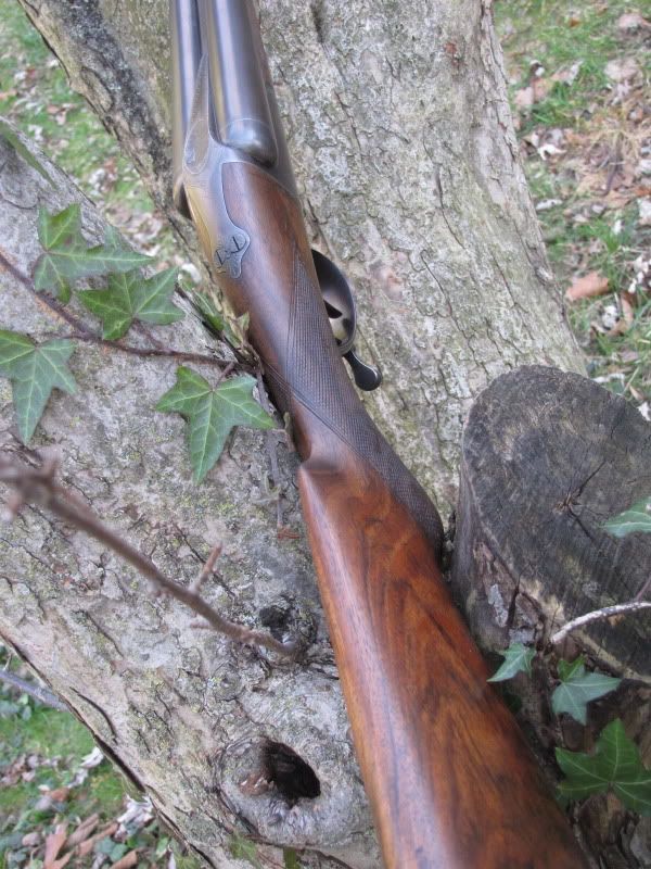

Thanks for the recs, gentlemen all! All back together this morning. Before and after below. JC, if you look in, I used a length of 3/8" dowel to block the bolt to the rear in the bar, which, as you know, also pushes the lever into the "up" position such that the slot in the trigger guard will engage and drawing the linear strikers to the rear making the hammer notches (for want of better words) accessible to the sears as the front of the trigger plate goes in. Dissassembly with a broken return spring is a special case of it not being necessary to follow the Manufrance catalog takendown instructions. With the lever return operating and under considerable downward pressure, takedown and buildup both require that the bolt be blocked to the rear. Any chunk of pine or hardwood, plywood, perhaps even a small metallic cartridge case of the correct length would serve the purpose of the tool supplied by Manufrance.
