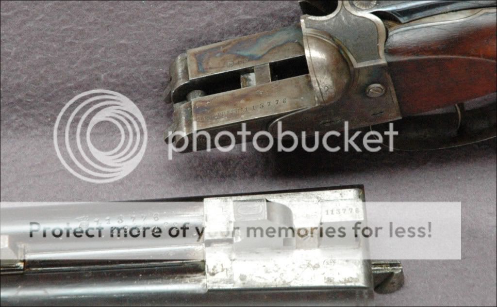

Here's the pics of the Cabela's Sauer Model 8(not Model 1 Daly?) Daly #133766 which I guess to be circa 1912:
There looks to be the initials of a script "L.L." under the left tube near the serail number and "295 C".
Leon Leclercq used LL. However, I never recall seeing script being used.
Posts: 12,832
Posts: 12,832
For now I can only think of Ludwig Langebarthel, but I think him to be long expired by 1912, but I guess there's still a chance.
