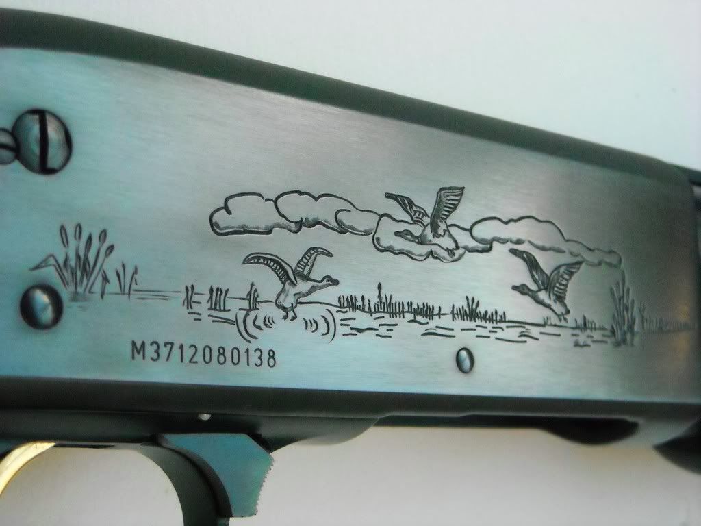

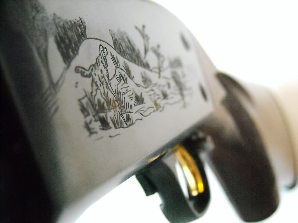

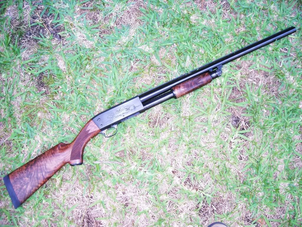

All apologies upfront; I don't want to hijack your thread MikeA., but I asked the mods last week (without receiving reply) about simplying showing what Ithaca Guns in Sandusky is doing these days w/ M37's, especially considering many's appreciation for these shotguns and because they'll be producing doubles. So if i could slip in that I can't be happier with a custom ordered 12 gauge M37 received the other week from Sandusky OH. Factory custom stock worked to my needs, 24 lpi, light right-side palm swell, traditional gold bead sight, and a receiver w/ chase hand engraving (plus added fill and sceneing at engraver's discretion) - can't wait to put some shells through it and look to order a custom O/U or SxS when they're ready. Mods please cut or move my reply if it is innappropriate. Good luck with the prospective purchase!

That's a beautiful piece of wood! I ordered the same gun in 16 gauge from the previous owners and got crap for upgraded wood, after two stocks, I sold the gun because of the taste in my mouth.
It looks like the present owners understand guns better. I really like the chased roll markings! I assume its 3" chambering?-Dick
