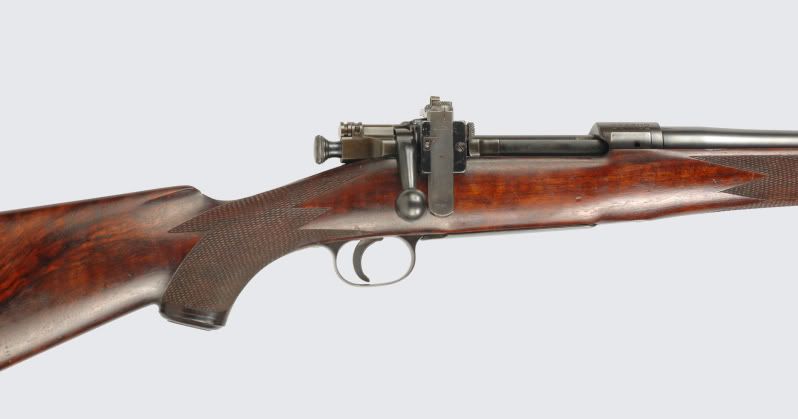

Unless any new information comes to light this is an early Adolph. It will make a nice companion piece to the K-Adolph below.
Wundhammer Restoration Completed!
I would like to thank the following people without whose help this would have been impossible.
Gary Bush: For alerting me to the stock and for supplying the Lyman 48 long-slide as well as the bolt.
Don Wooldridge: For supplying the proper NRA sales rifle.
Barry DeLong: For supplying the Ross Barrel band sling swivel.
John Beard: For making sure I had all the proper parts for the rifle.
John Wills: For help turning the rifle between centers to bevel the front of the receiver, contouring the barrel, making the barrel bushing for the threaded front and for grinding the tang.
Jim White: For checkering the panel on the underside of the bolt.
Monte Mandarino: For repairing the stock and blueing the barreled action.
http://forums.accuratereloading.com/eve/forums/a/tpc/f/9411043/m/971104608/p/2

Very nice Michael! I must admit, when you started with a stock to restore a rifle, I thought you a bit touched, but only 15 months later you've got a great example of a rare vintage rifle.
Congratulations and well done!

Thanks Steve. A bit touched you say, that's one of the milder ones I've heard regarding this project. I am very happy with the rifle and although it did take a while the end result was worth it. I believe that everything was done the way Mr. Wundhammer would have done it. I think that I should start marking these with a mark that can be seen without taking the rifle apart. A subject that should be discussed one day.
