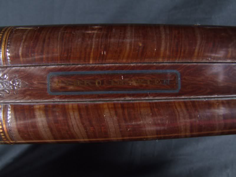

I think the pictured "6 iron Turkish" in the other post demonstrates what occurred very well. Note that the pattern runs across the barrels as one would expect as these were hammer welded around a mandrel. Also note the pattern runs along the rib leading me to believe this rib was formed as a long strip.
The pattern however appears to be consistent between the barrels and rib.
Jim
Posts: 12,831
Posts: 12,831
PeteM:
Who is firearms merchant from Vienna on the top rib? I assume those are Belgian pattern welded tubes? True, small arms tube making was a small sideline as the steel producers and rolling mills were interested in huge public works and machines of war.
Raimey,
I do not know. All I know is that it is an Austrian muzzle loader. I had assumed the damascus was either produced in Austria, perhaps Italy as it very much like the Beretta damascus of this period I have seen. Honestly, I have not seen enough of the Austrian or Beretta damascus to be certain.
