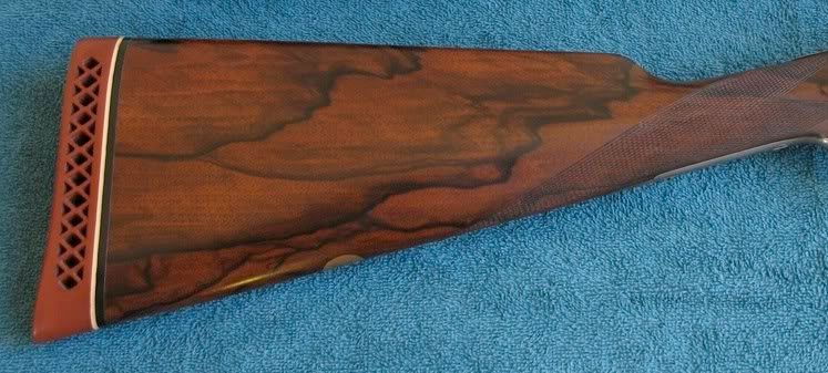

Jonty, thanks, that's reassuring about the newer Silver's pads. I had given some thought to the Old English pad. Are they as sticky as the regular Decelerator pads?
The gun balance is an important consideration to me. I'll be comparing weights to the existing pad once the new one is ground to size. Perhaps strategically removing some rubber through the back side is an option there.
eightbore, thanks for the info. My current white line Pachmayr pad has holes 3" apart. I found one reference to the holes on the old Silver's pads being 3" apart as well.
Here's the pad I'm planning to replace:

Looks like an older Red Winchester vented pad from Pachmayr- I have several of these, an Ithaca red Sunburst, a Pachmayr tan vented Browning, and a few misc- all original "take offs" not the new "reproductions" plus a few misc older non-logoed black Bakelite buttplates--

Hi Mike,
the Old English pads are fine (I think their Pachmayer code is the 752 pad)the decelerator pads are too sticky for me though.
As they are significantly lighter than Silvers they have worked well for me on guns that don't have enough wood left in the stock to hollow out to put the balance of the gun right.
I always weigh the gun first and make an exact note of where the balance point is before making any alterations. I have found that the silvers weigh a lot more due to the denser rubber and solid construction.
On average I have found that a Pachmayer Old English Pad weighs around 4 to 5 oz, and it is usually possible to offset this weight by hollowing out a stock with a 1" auger bit to get the balance back.
I have also found a MAD drill bit very useful as it cuts sideways / up and down as well as in depth. This is useful if you want a small hole into the rear butt of the stock to retain the pad mounting screws and then you can hollow out inside the stock - like a large cave inside, but with a small entrance. BUT you do have to be very careful, go slowly and I use calipers to make sure I maintain wall thickness.

... the Old English pads are fine (I think their Pachmayr code is the 752 pad)the decelerator pads are too sticky for me though.
I hadn't realized, until following up on your post, that Pachmayr has two Old English pads. The one you refer to, the 752B, and the Decelerator version D752B. I had only encountered the latter before and likewise find them too sticky for my taste.
