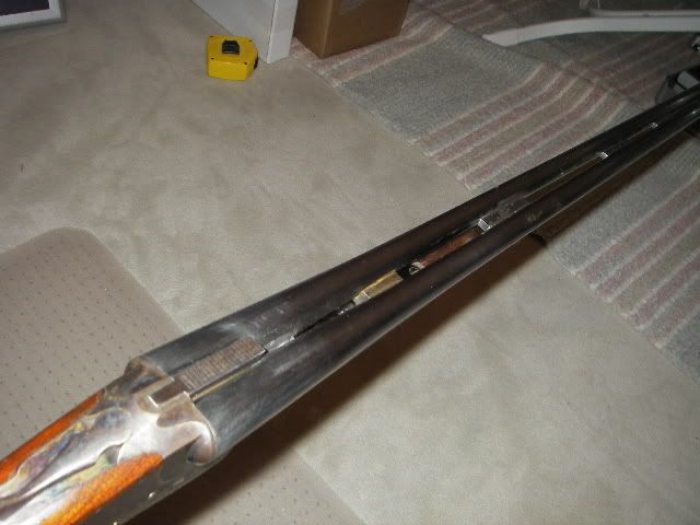

I used the Hi-Force 44 with the 600F ish melt temp for assembling the spacers in a project. My thought was to use 60/40 for the ribs.
