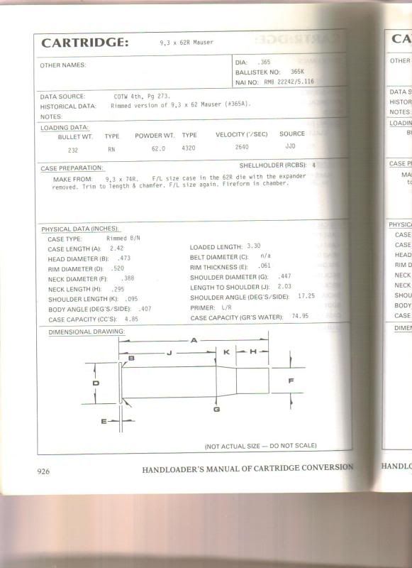

Gentelman look at the man question again. He is talking about a rimmed version. The 9.3x62R can be made by using 9.3x74R,available from RWS.

There is a 9.3x62R Mauser, arimmed version of the 9.3x62. It is a very powerful cartridge. I don't know how old your drilling is. The only way to be sure is to get a chamber cast and have it measured. I am sending along some info for you to look at, hope it helps.
Rich
Rd Show #124464 12/05/08 10:45 AM
Posts: 236
Posts: 236
[img]http://
This is from cartridge conversions by John J. Donnelly

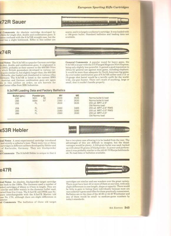

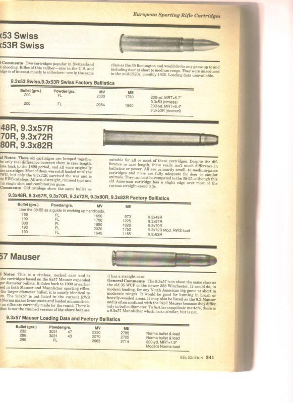

These are from Cartridges of the world By Frank C Barnes 6th edition.
[img][/img]
[img][/img]

Rich,
Very informative
Thank you.
