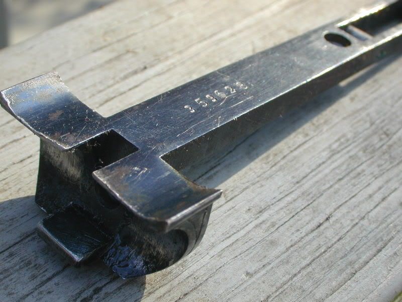

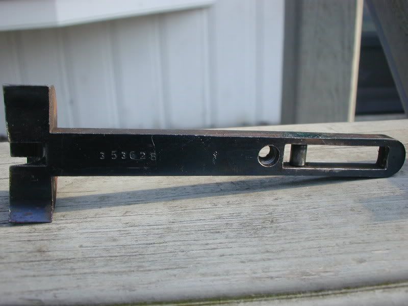

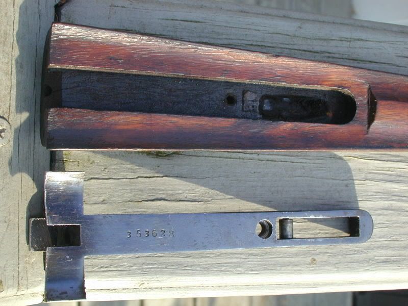

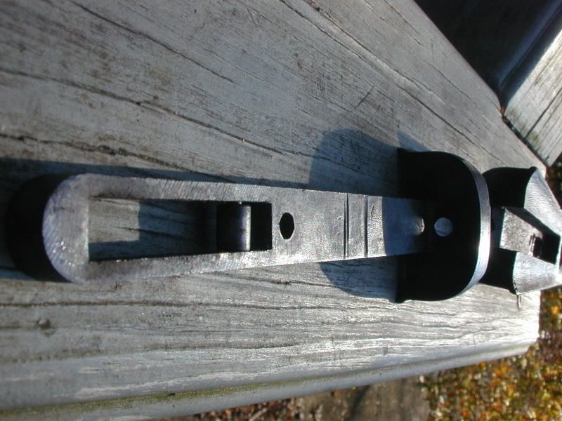

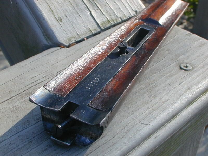

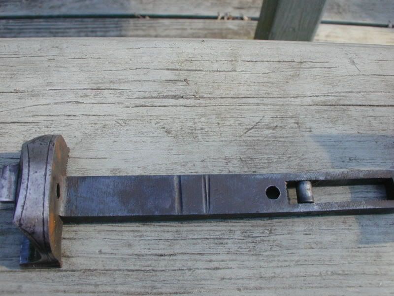

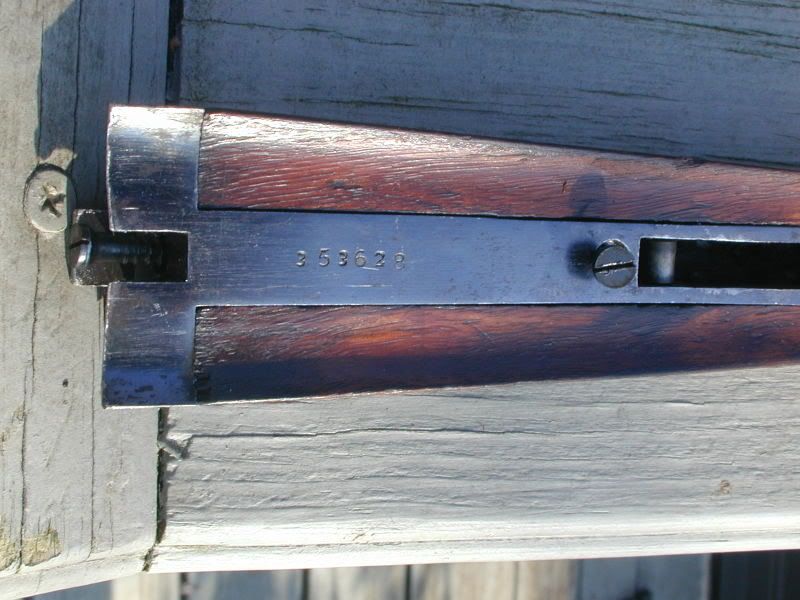

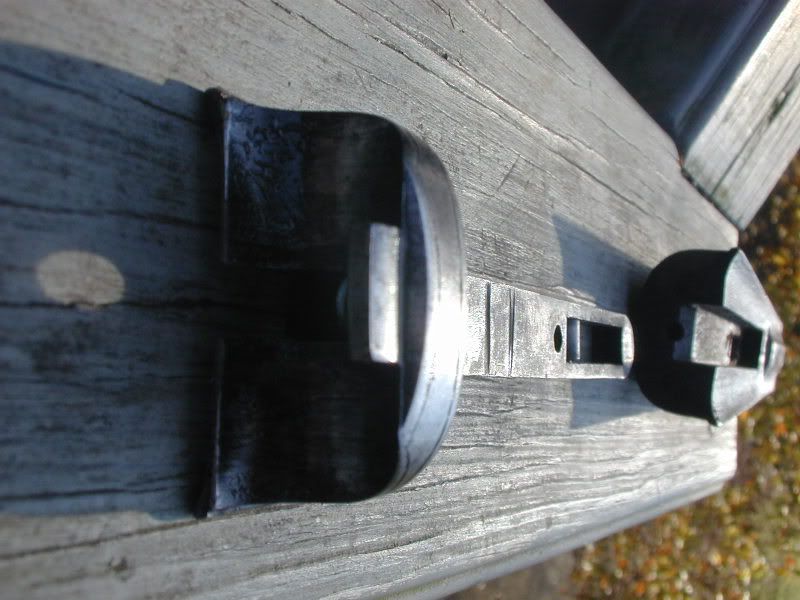

Pix of roller latch extractor iron and forend from Philly 16 ga SW. Probably should have a pic of forend lug also but I forgot. May be irrelevent now if you can find OEM and I have no clue as to how your smith would machine one without a dimensioned drwg. but here they are.
jack
