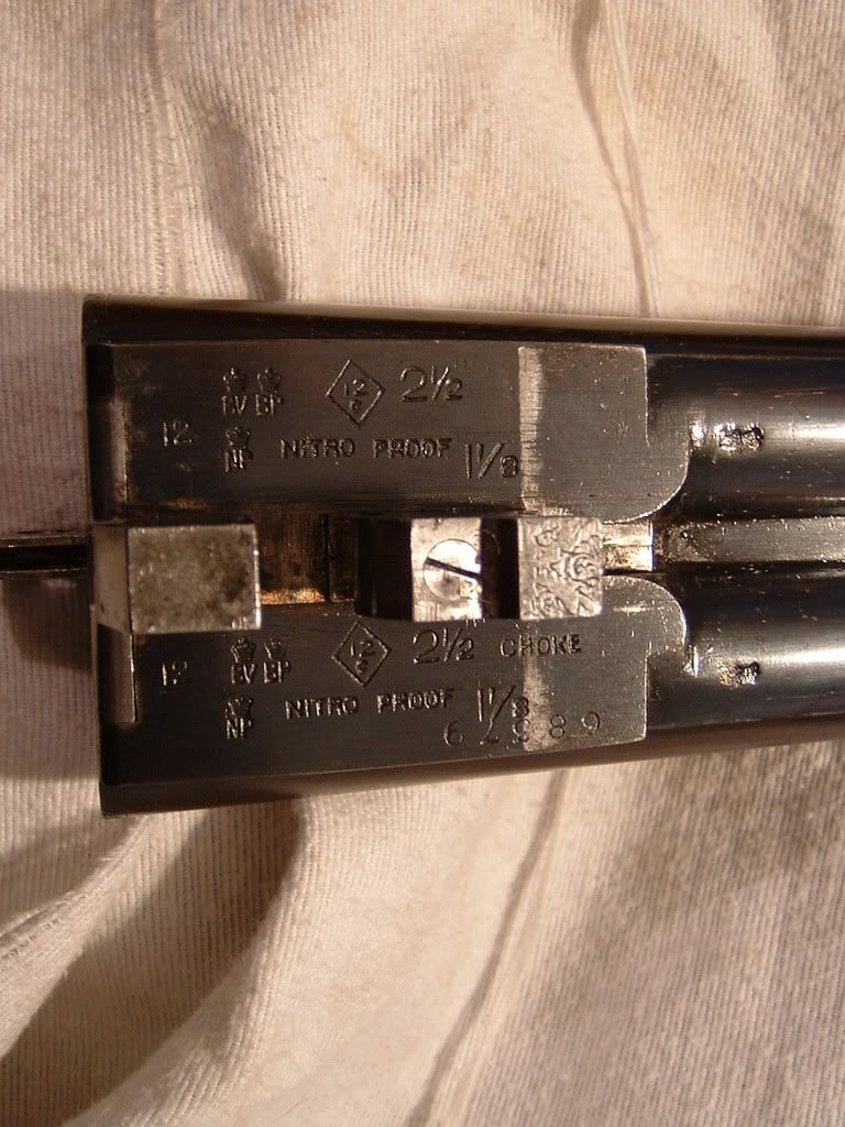

First the proofs.
Is the diamond with the 12 over a G a duplicate mark to the number 12 stamped at the breech mouth, or is it something relating to the charge of powder? Or?

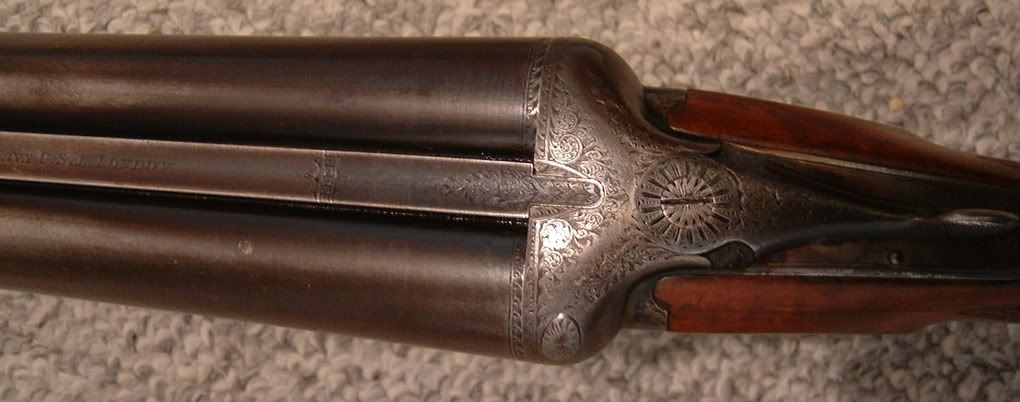

The top view of the action. Sorry about all the carpet. At least I got my toes out of the way, eh?

Trev, that's definitely the "Anson" model, exactly like mine, and less than 150 numbers apart. Proofs . . . those are exactly what you would expect to find for a British gun made in Birmingham between 1925-54. The 12 over a C in a diamond simply indicates it's a 12 gauge and the chambers are shorter than 3". The "choke" means that the barrel has at least a minimum amount of choke; going from recall here, but I think it means more than .006 or something like that.
Using a Galazan chamber gauge, the chambers on my A&N's measure about as dead on at 2 1/2" as you're going to get.
Powder charge . . . Unfortunately, all you can tell from the proofs is that at the time the gun was built, it could be used safely with any 2 1/2" British shell containing 1 1/8 oz shot. I have been reloading standard 2 3/4" hulls to appropriate low pressures and shooting them in my guns--a lot--for the past 3 years. Mostly 7/8 oz target loads, but some 1 oz and 1 1/8 oz hunting loads. No problems whatsoever.

The action is clearly a W&S "Proprietary", except for the cross bolt. The 1914 and 1939 W&S catalogues show it as a screw-grip action. The engraving pattern would fall somewhere beween the very plain Grade 3 and the fancier Grade 2. I imagine A&N had the purchasing power to get the cross bolt and brand specific engraving. Perhaps A&N staff believed cross bolted guns sold better than screw grip guns or there was a ptice/profit difference. It most certainly came from the factory as a sound and servicable gun.
Here is the same basic gun as a screw grip and in Grade 2 get-up for James Woodward (sold in 1910).

larry Brown is right on with the period of proof. The 1 1/8 is the mark applied to indicate it has standard 2 1/2" chambers. If it had 2 3/4" chambers it would have the 1 1/4 oz. mark. The chamber may measure slightly longer due to the angle of the forcing cones or, if someone has lengthened them which would render them out of proof under British proof law. I think that you will have a standard 2 1/2 " chambered gun. Just an adition; if it was meant for 3" cartridges it would have an 'L' after the 12 over C in the diamond to indicate 'Long' chambers or the 1 1/2 oz. mark. Lagopus.....

Rocketman, it's straight out of the 1933-34 A&N catalog as an "Anson" model. Same crossbolt, same engraving. And the order sheet on my guns is clearly marked "W&S" (Webley & Scott).
Posts: 5,954
Posts: 5,954
Thanks, Larry. The "Anson Model" does not appear in either the 1914 or 1939 catalogues. Does your gun have the semi-circular stock inlet at the junction of the tang and the action fences? Also, does it have a screw slightly behind and below the hinge pin? I haven't found these two features illustrated on any guns other than the Proprietary --- but, then, neither have I seen a Proprietary with a cross bolt illustrated, either.
