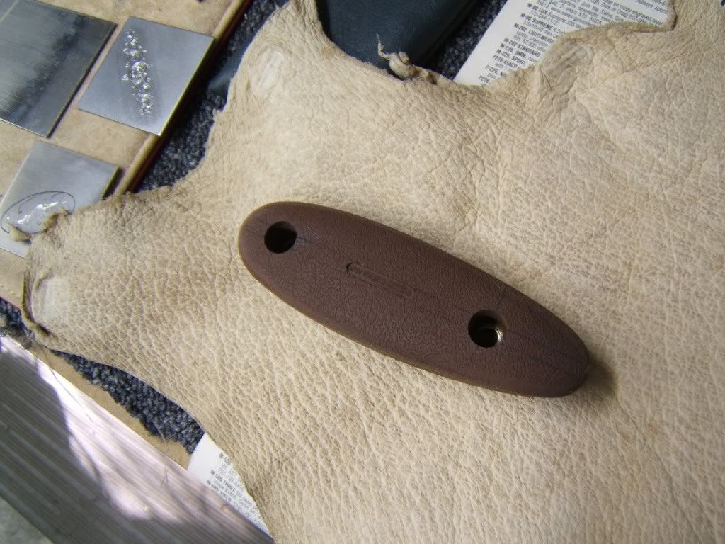

Chuck I located some thin pig skin locally...looks like I'm going to have to try again.

jOe,
CJO posted the full how-to. I will try to make it available as an attachment tomorrow.
Would not come up in the search.....or I am just too tired to see it!

What are you looking for Mark?
CJ
Send me some if you get time.
Are you gluing the rubber plugs in ?
It was an old post you had about leather covered pads...I looked back through your old posts I found it but link in the thread to the original thread didn't work.

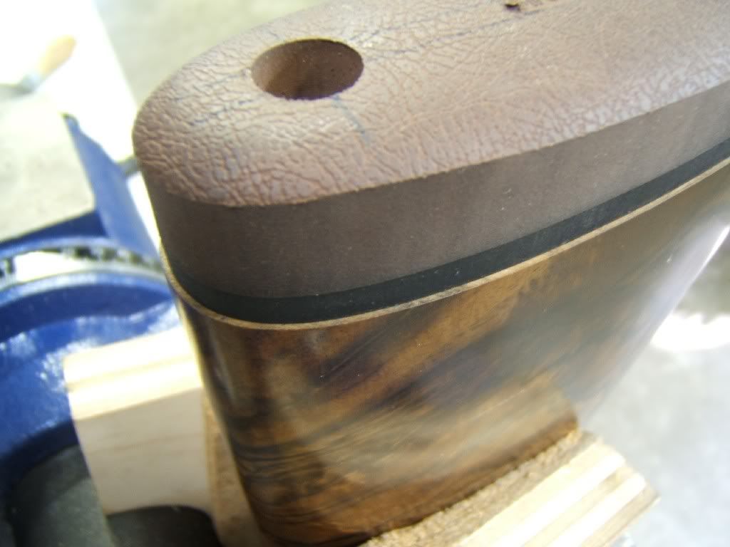

Joe,...those pictures were on a different hosting site and are now gone. I don't have them here but have others from different jobs I can show you.
If I may critique,...I think you're close but you should fit the pad to the wood and allow for the exact thickness of the leather all around,.. I use fairly thick leather, about .040" I find it more durable and unless I have to make a pad over 1" thick I don't usually have any problems with it
Also , curved pads can be done but unless the back of the pad itself is curved to match the wood and remain rigid it'll be difficult to get it just right
CJ

jOe
I do not glue the plugs in. They are long enough and friction does just fine. When I get home I will forward some pics of the holes and the plugs. I am in Madison Wisc. this week.
