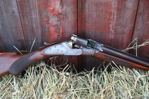

Sometimes I think jOe is twist (ed) lol
This is yO gun on Nitro..
