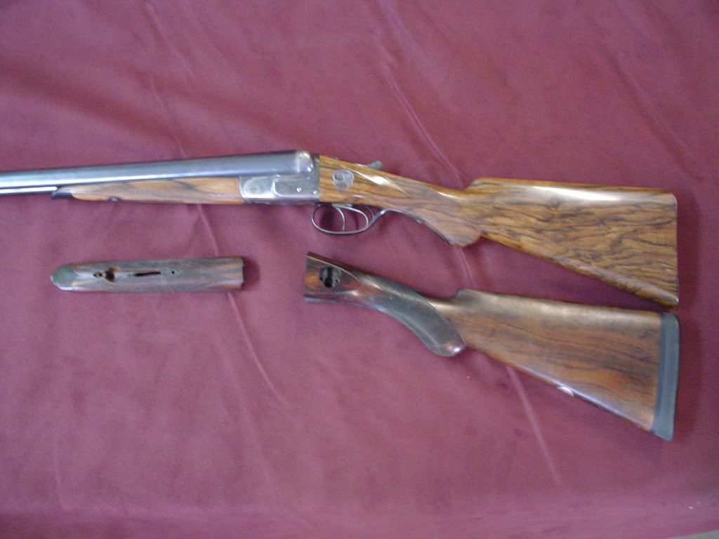

Sometime ago I bought a very nice W.W. Greener FH25 12 bore from a good friend. The gun was in excellent condition and has alot of really cool features (Facile Princeps action, ejectors, 30" barrels, light weight, etc), the only thing wrong with the gun was a severely cracked/broken stock...it look like someone tried to bend the stock to give it some cast on and it snapped at the wrist. I decided to have this gun restocked. After saving a few nickels I bought a decent blank of english walnut that fit the bill for a Greener, proper grain flow thru the head (maximum strength so no cracks develop around the safety) and proper flow thru the wrist area, I looked at a number of blanks before buying this one, it was tough finding one that met the criteria. I sent the gun out to my stockmaker, according to him its coming along nicely, it has taken a little longer than usual due to the complexity of inletting the Greener side safety among other things that are unique to Greeners built on the Facile Princeps. The project is almost done, some building up of the stock finish, rust bluing the heel and toe plates, assembley, etc. Here is a pic of how the stock is coming along.
The forend may seem to be a different shade, its the light. The forend was cut from the same blank as the stock and is an exact match.

Mr. LeFusil
It looks real nice, but one would need more pictures to be sure... I really like the widow's peak forend tip.
I have a small weakness for a Greener and look forward to seeing more of this one.

Glenn,
You and I both know that you will be seeing alot more of this particular Greener ;). As soon as it is assembled and cased...it'll be on its way to you for your "finishing" touches. It'll really be something when its finished.

Yeah, I guess you could say thats a pretty nice hunk o' wood. Beauty, thanks for sharing. Be sure to show us the finished product.

LeFusil That is a AWESOME piece of wood, nothing shows off a fine gun better than it's wood. I hope that you post the rest of the gun when it is done i would most like to see it.

Fantastic!!!
I just picked up a Empire Grade yesterday afternoon. I need to find/make a new forend cap for it.
Be sure to post the finish product!!!

I KONW you will be more than pleased with Glenn's work !! Great looking stock too. Ken

Beautiful

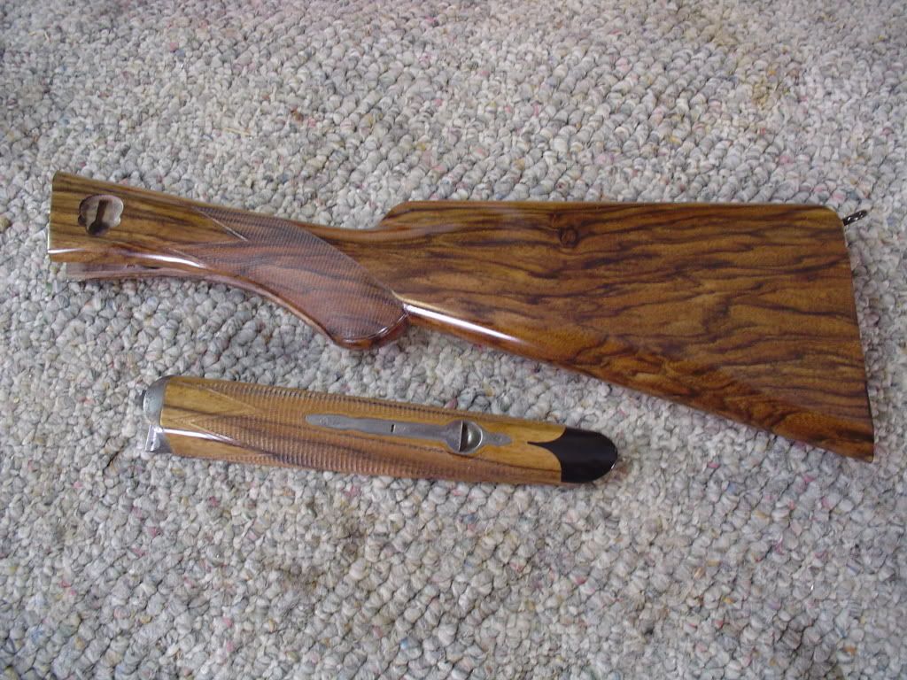

The project is near completion, here is how the wood looks when slapped on the metal....
