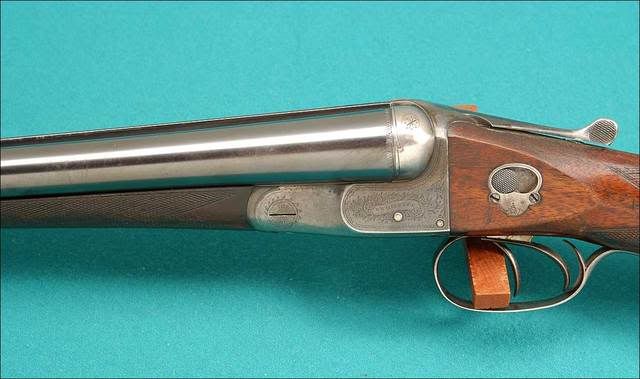

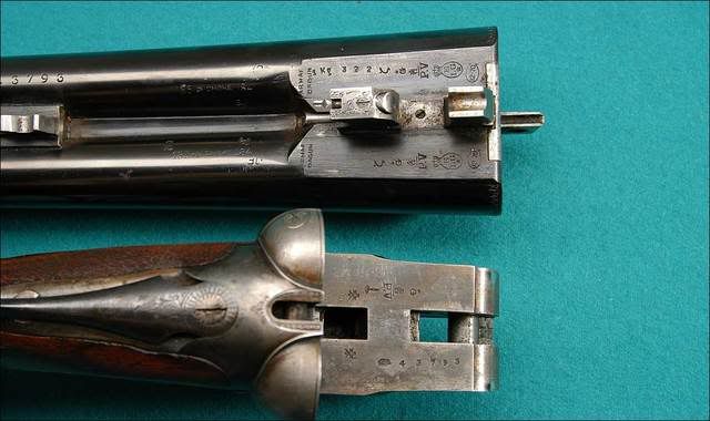

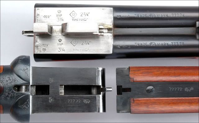

Thankyou so...
This is most likely an authentic Greener ???
This is almost surely a FAKE ???

The upper gun has post 1954 Birmingham proof marks, the lower one has Belgian marks. The crossed Scepters ceased to be a "Proof" mark in 1904. If memory serves me correct they would have been marked on this gun by the proof house as a date code.

Josh, without researching the proof marks too closely, I believe the lower gun is a real Greener circa 1895 that has had a set of belgian barrels fitted at a later date and proofed in Belgium.

Miller, you're right about that mark being a Birmingham date code, starting in 1921. It was dropped in 1941, then reintroduced in 1950. If you can read the letter, which can be difficult sometimes, it's a good way to date a Brit gun. However, the London Proof House didn't use the mark or any other date code until 1972. After that, their code is pretty simple: LP with the last two digits of the year underneath.
Terry, do you see anything on the water table of the 2nd gun to indicate it's British? I can't see all the marks clearly, but the perron and the PV--which I can see clearly--are certainly Belgian.

Look at the top set of barrels.The Elephant symbol inbetween Trade Mark is Bill Greener's mark ( William Wellington Greener) but Bill to his friends.

Larry, I believe we have the original British black powder proof marks on the flats with the later Belgian nitro proof marks added. The serial number corresponds to Greeners numbers for 1895. Would be interesting to know if the gun has the usual side safety?? The action also looks older and more worn than the barrels, that look more recent.
Larry, I just pulled one of my Greener guns from the same era and it has the same two crossed scepter black powder proof marks as well as the mark to the left of the serial number on the flats which appears to be another version of the Greener "elephant" trade mark. I rest my case.
Yes, it does...
