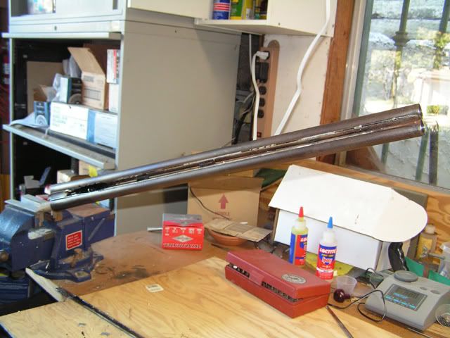

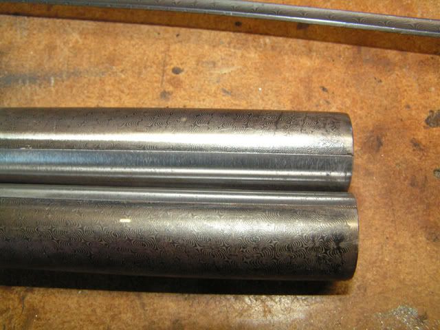

Onward on this project, I just pulled the ribs. I'll prep and try to get them re-layed today. Standard goo between them and the start of some rust. I'll clean that up and re-tin the areas that have delam'd. It was worse than the outer appearances let on. It was delam'd about 3" long on one side. From the outside it looked like only an inch.
First pics are what showed.

Well after some cleaning of the rust and crud between the ribs, great news! No pitting. Whew! That was my biggest fear.
Here's the so called "keel". Seems like such a large name for such a small part. Something like "nib" would seem more fitting.
Here's an interesting cartouche on the underside of the toprib.
