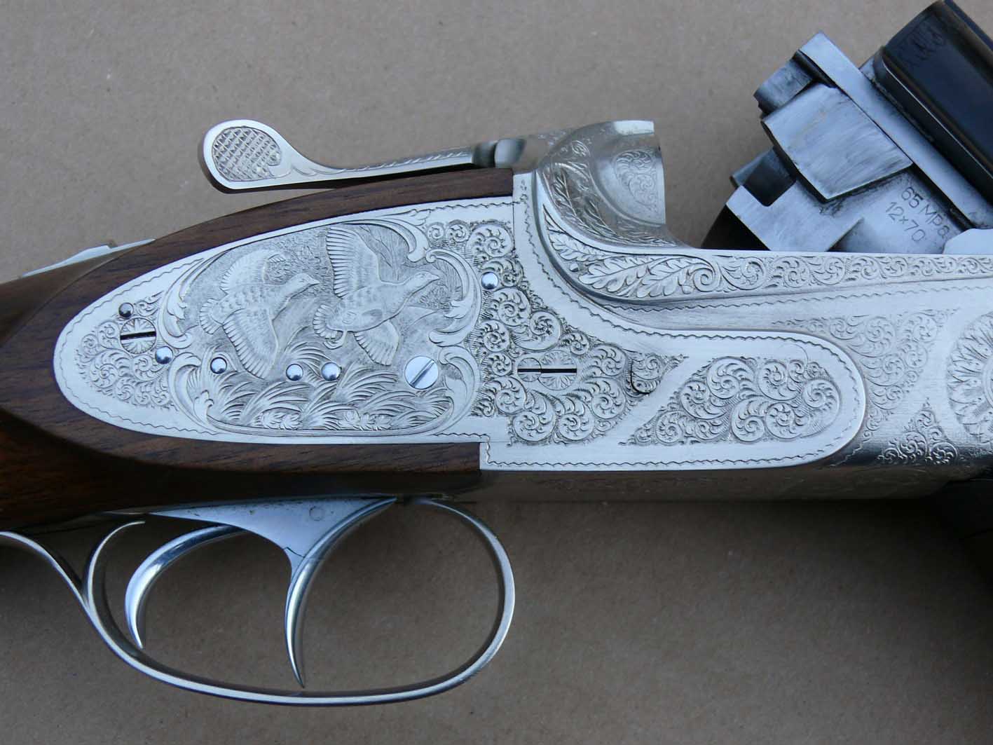

Not sure what you have seen, but with raised cheekpiece is something from Central Europe.
Lets not forget the gems from bad ole' USSR!
PS. If not for 650bar 12gax70mm marking that piece could be easily mistaken for something from Suhl or Ferlach. Please note how lovingly shallow the depth of that action is. Very unlike most Germanic ones.
