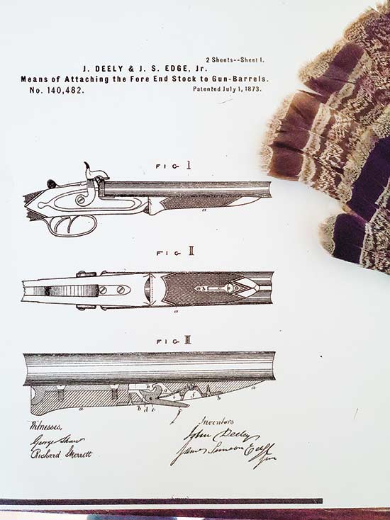

I assumed from the start that the "half a safety pin" he was using as a pry tool was actually half of a wooden clothes pin, which is something often recommended to pry difficult forends loose. And even if the lug solder joint was defective, it wouldn't be able to move to such an extreme angle as to impinge on the latch mechanism... the OP clearly said it would lift "only part way" and "even if he put quite a bit of pressure on it". You had to be really hitting the bong to imagine a tiny movement of a loose lug would "impinge" upon the nose of the latch in such a way as to stop full movement, even with quite a bit of pressure on the end of lever. The mechanism of a Deely latch is not very complex, and not much movement is required to disengage the locking end of the latch from the notch or bite. The illustration below shows the lever provides good mechanical advantage.
I don't expect you to understand this, but I put this picture here for the benefit of those who actually have some mechanical aptitude. You very recently demonstrated severely poor mechanical aptitude when you insisted Daryl's mystery tool was a percussion drum removal tool... another wild swing for a strike.

I'm sticking with my prior assessment of the repair, which makes a lot more sense than your imaginative but virtually impossible scenario. The latch lever would not move far enough to disengage from the bite in the lug. Removing or loosening the cocking levers as Bushveld suggested certainly wasn't going to do it either. It may have helped if the problem was that even with the latch fully disengaged, the forend iron was unable to rotate around the action knuckle. But that clearly wasn't the issue. With the mechanical interference created by a partially engaged latch, there was no way the forend was going to come off other than pulling on it hard enough to separate the lug solder joint, or alternately, splitting or otherwise damaging the wood in order to see why the latch lever was not able to disengage.
